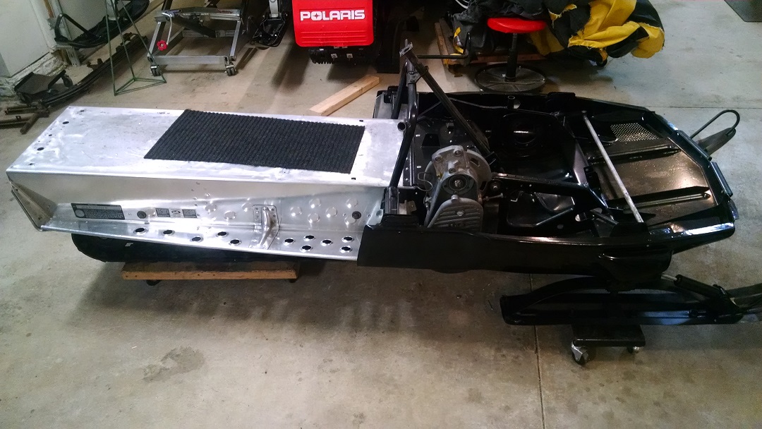

Well its finally time to start putting this sled back together!
When I am done I plan to sell it to fund some other projects I have on my plate...
So far:
Primary is rebuilt with a NOS purple spring, new weight bushings, and all cleaned up!
Secondary is rebuilt with new ramp slides, NOS Cam, & cleaned up

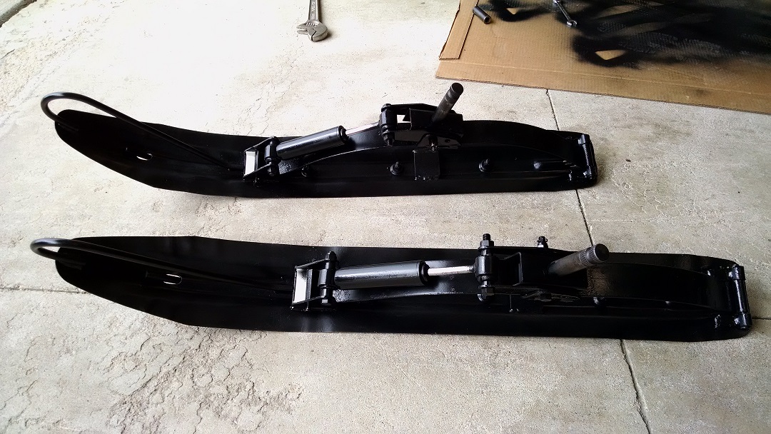

Ski assemblies are all assembled new wear pads installed, good carbides, & fresh paint

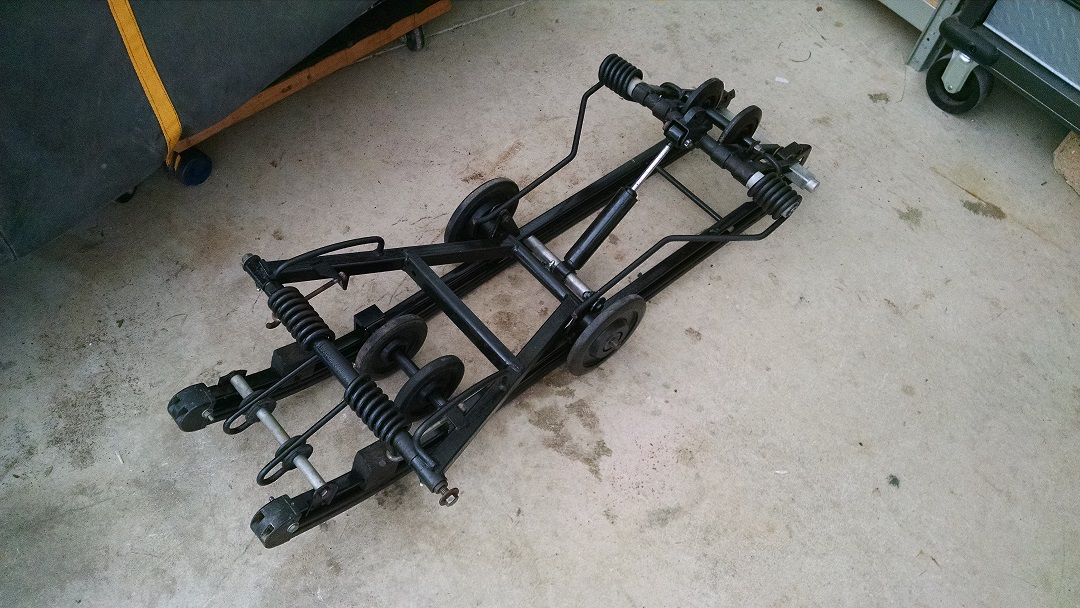

Rear suspension all rebuilt with grease zerks, hyfax, reinforced REAR arm, new idler bearing, etc...
Engine is done with: fresh crankshaft from Jerome, new water pump bearings, new SPI pistons, JD Gaskets, NEW crank seals, HSR ignition, rebuilt recoil.....
Tunnel is polished and bulkhead cleaned up and painted.
Here are a few pics...
So far:
