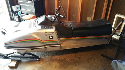

Well, about an hour and 20 mins from my doorstep was this 1982 Trailfire 340 Canadian Special. I saw it on Craigslist with some other sleds listed in a garage sale. After contacting the seller she informed me it didn't run and that it was an 84, I informed her that it was an 82. She originally wanted more than I was willing to pay and said she would check back with me. I figured it was just a run of the mill 82 340 Trailfire so I continued on with my day. Later on I decided to ask for a serial # pic just for fun, she sent one and boom! My jaw dropped, it was a c. Special! I immediately set up a time to get it. I pulled up and yup she was complete, and what I speculated. Motor is stuck after being severely violated by mice! It will take a donor motor or two to get one put together for her. Today was a good day.

Hood is nice, decals are nice, seat is ok, windshield is cracked, overall cosmetically nice

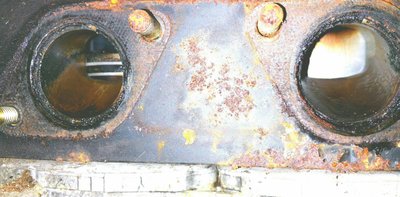

Manifold
Manifold
