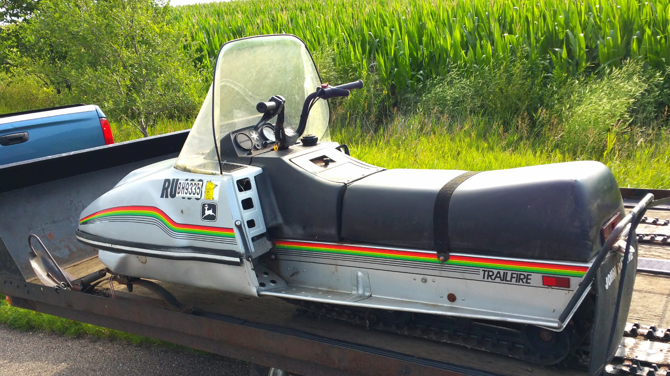

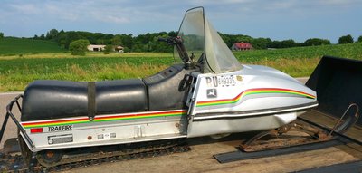

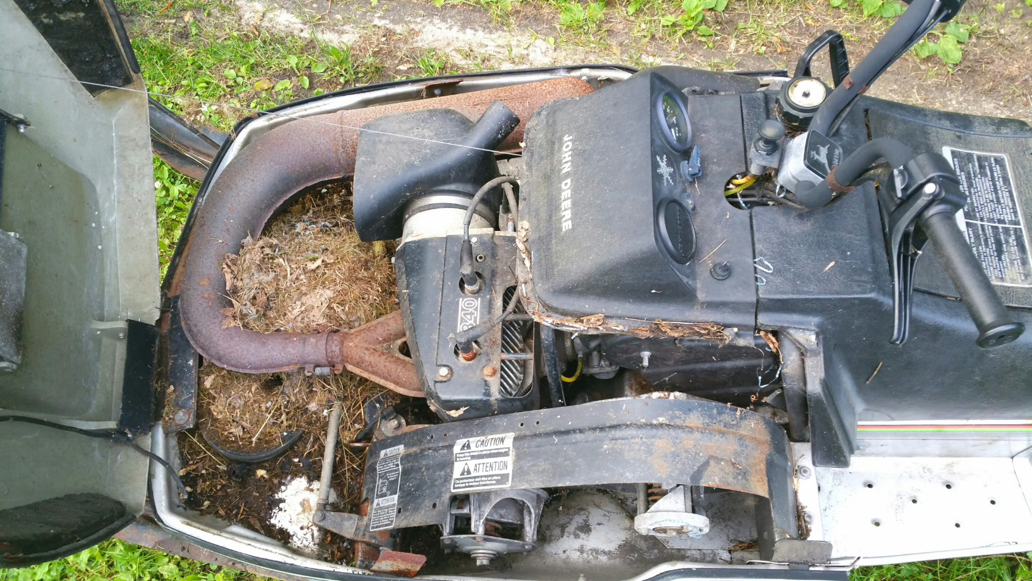

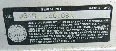

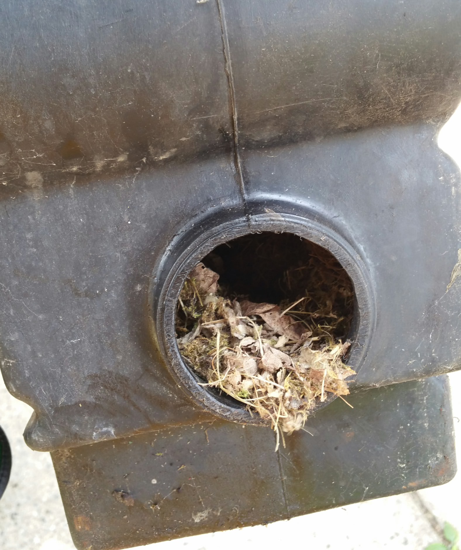

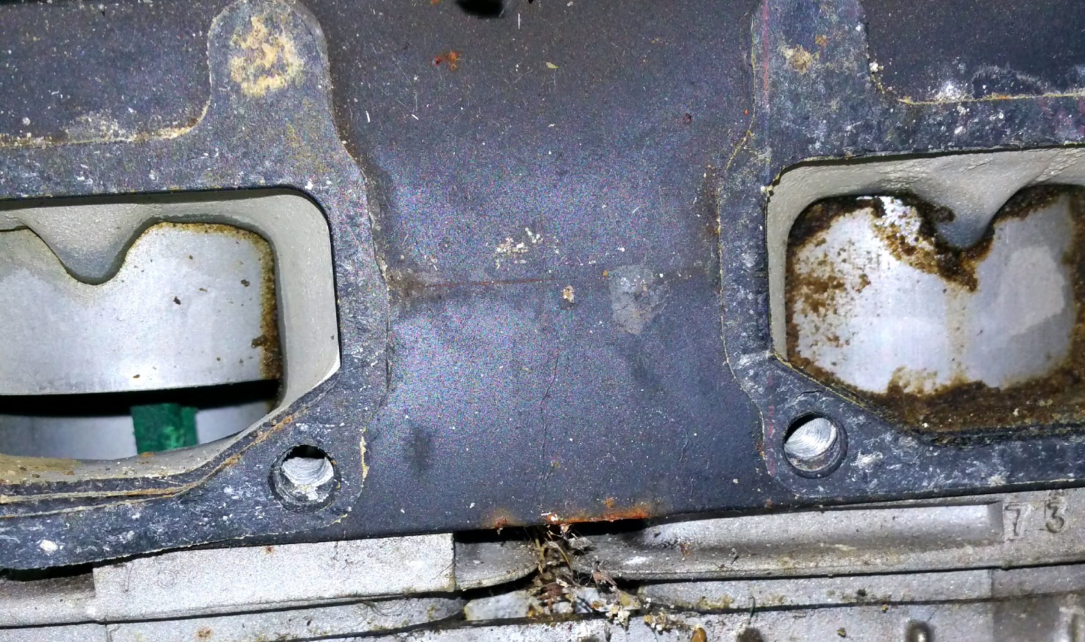

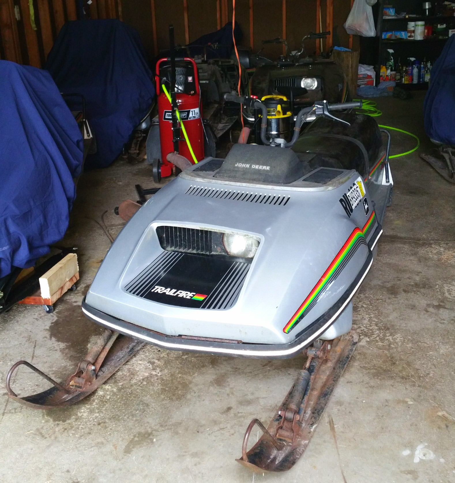

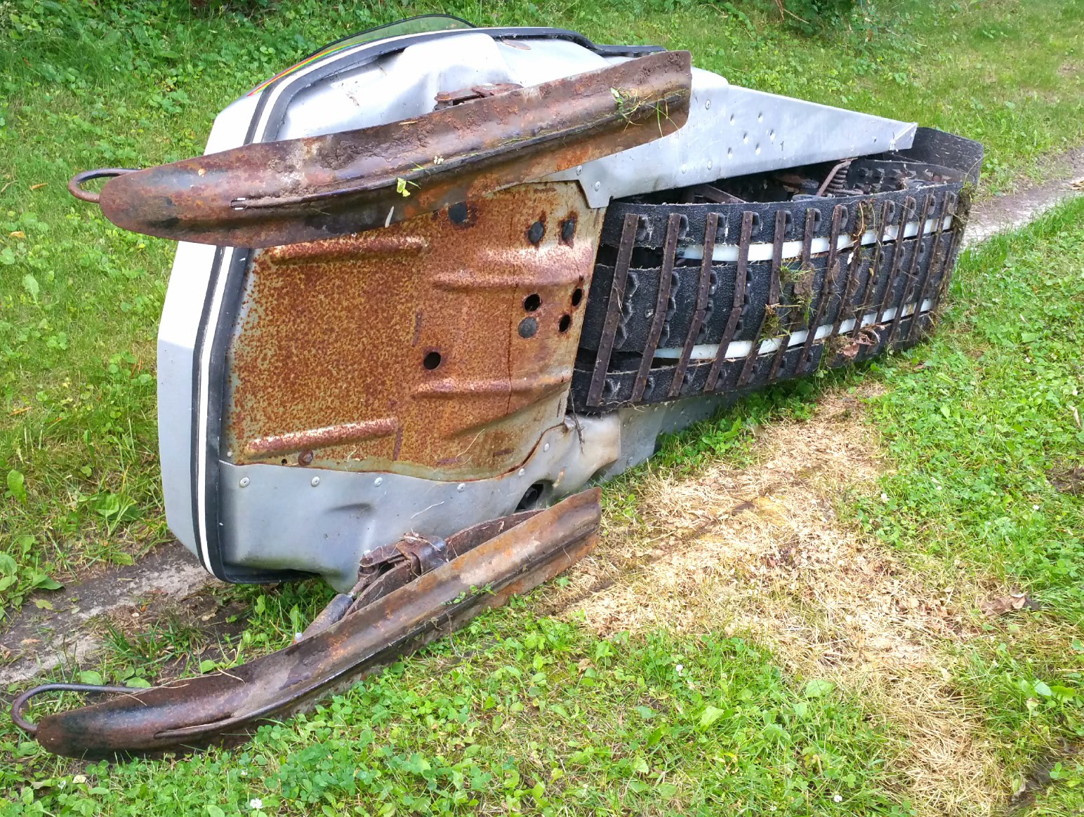

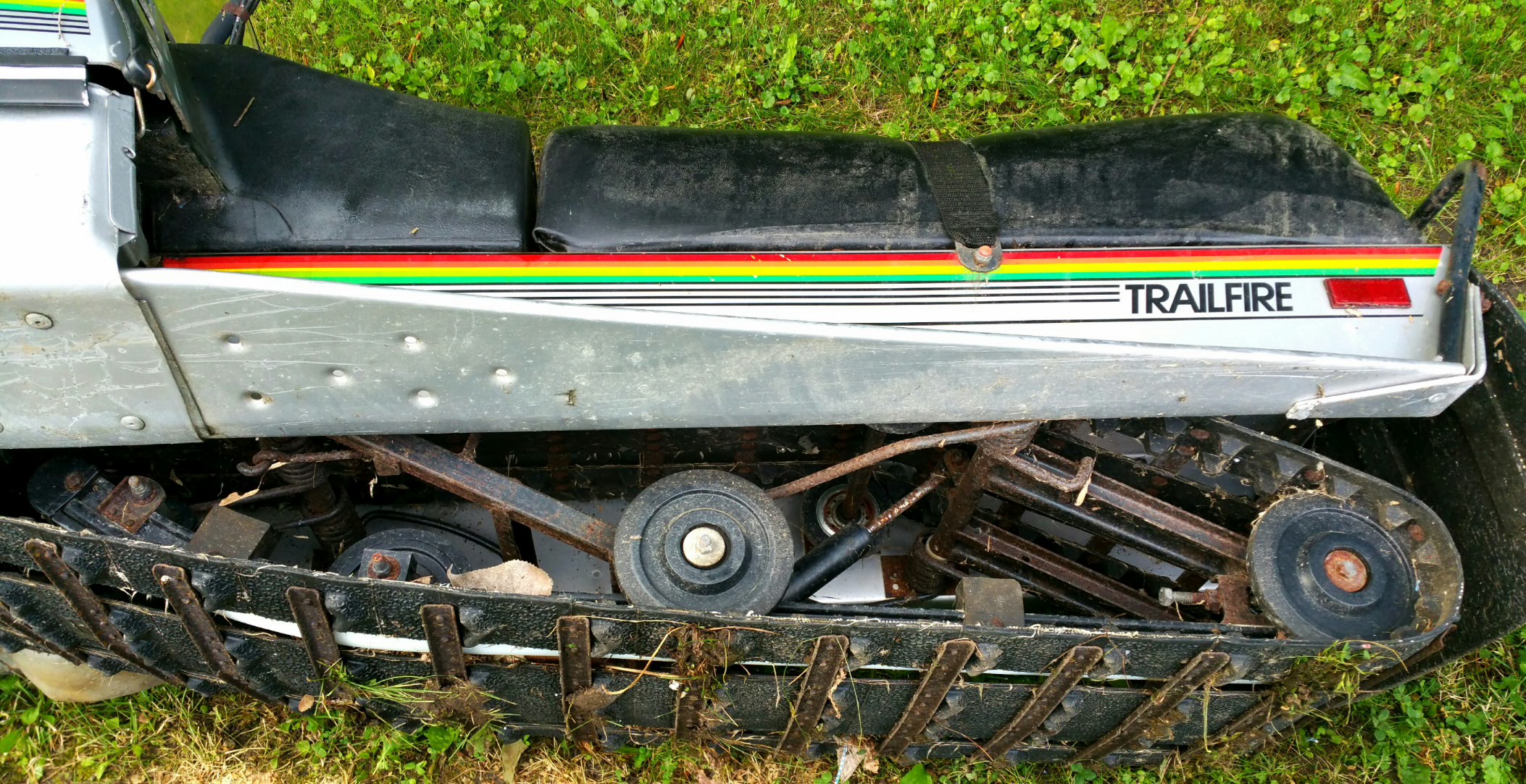

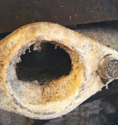

Well, about an hour and 20 mins from my doorstep was this 1982 Trailfire 340 Canadian Special. I saw it on Craigslist with some other sleds listed in a garage sale. After contacting the seller she informed me it didn't run and that it was an 84, I informed her that it was an 82. She originally wanted more than I was willing to pay and said she would check back with me. I figured it was just a run of the mill 82 340 Trailfire so I continued on with my day. Later on I decided to ask for a serial # pic just for fun, she sent one and boom! My jaw dropped, it was a c. Special! I immediately set up a time to get it. I pulled up and yup she was complete, and what I speculated. Motor is stuck after being severely violated by mice! It will take a donor motor or two to get one put together for her. Today was a good day.

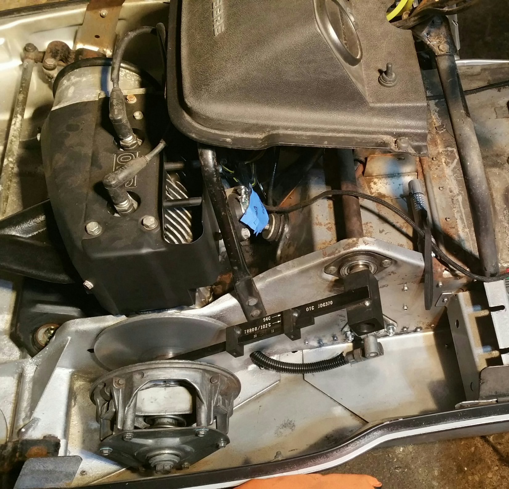

Hopefully firing her up soon, motor is all rebuilt, suspension is all freshened up, all new driveline bearings, drivetrain all gone through, clutches freshened and aligned, paint touchup, pictures to come soon
Re: Elusive 82 Trailfire 340 Canadian Special

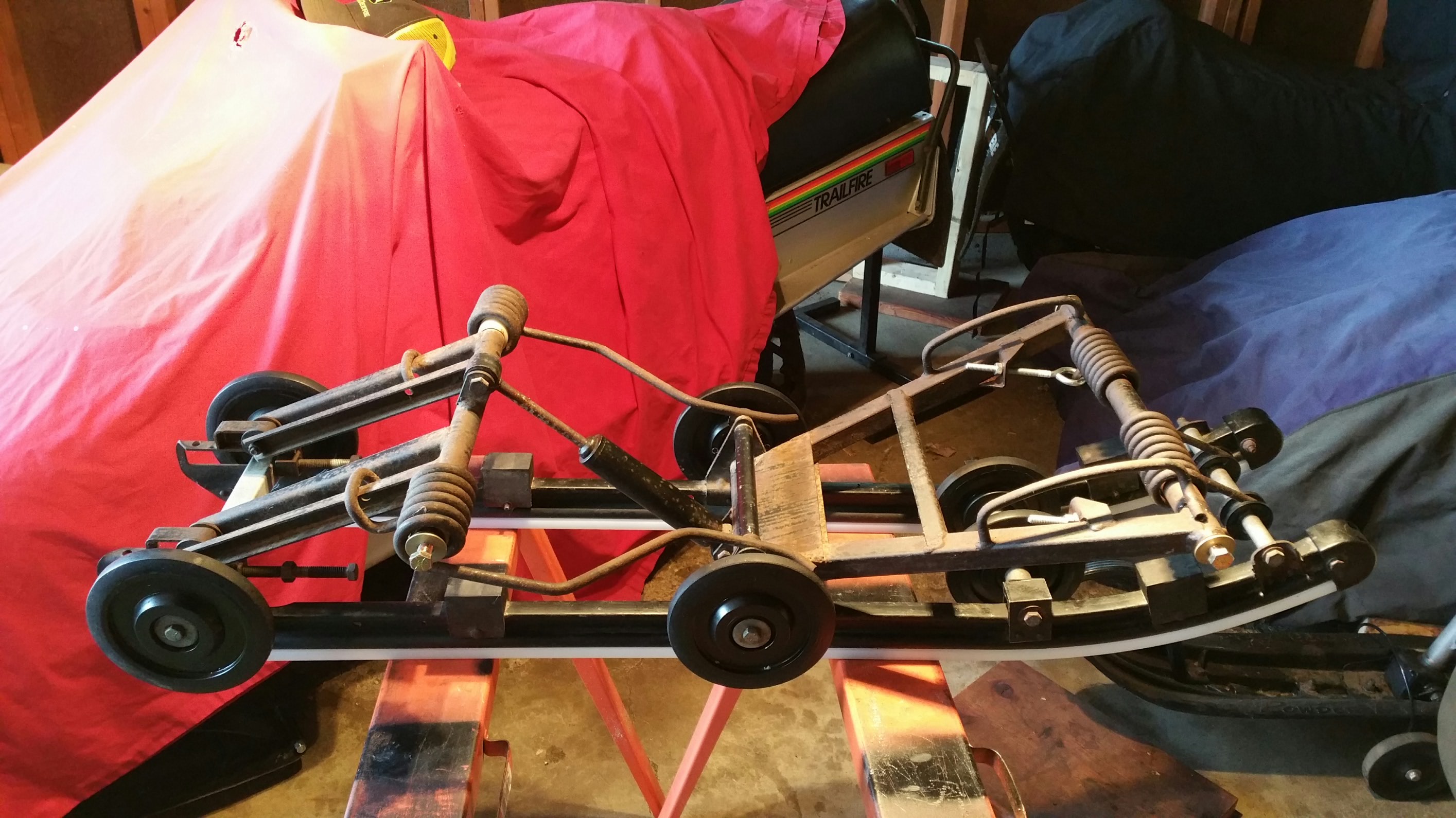

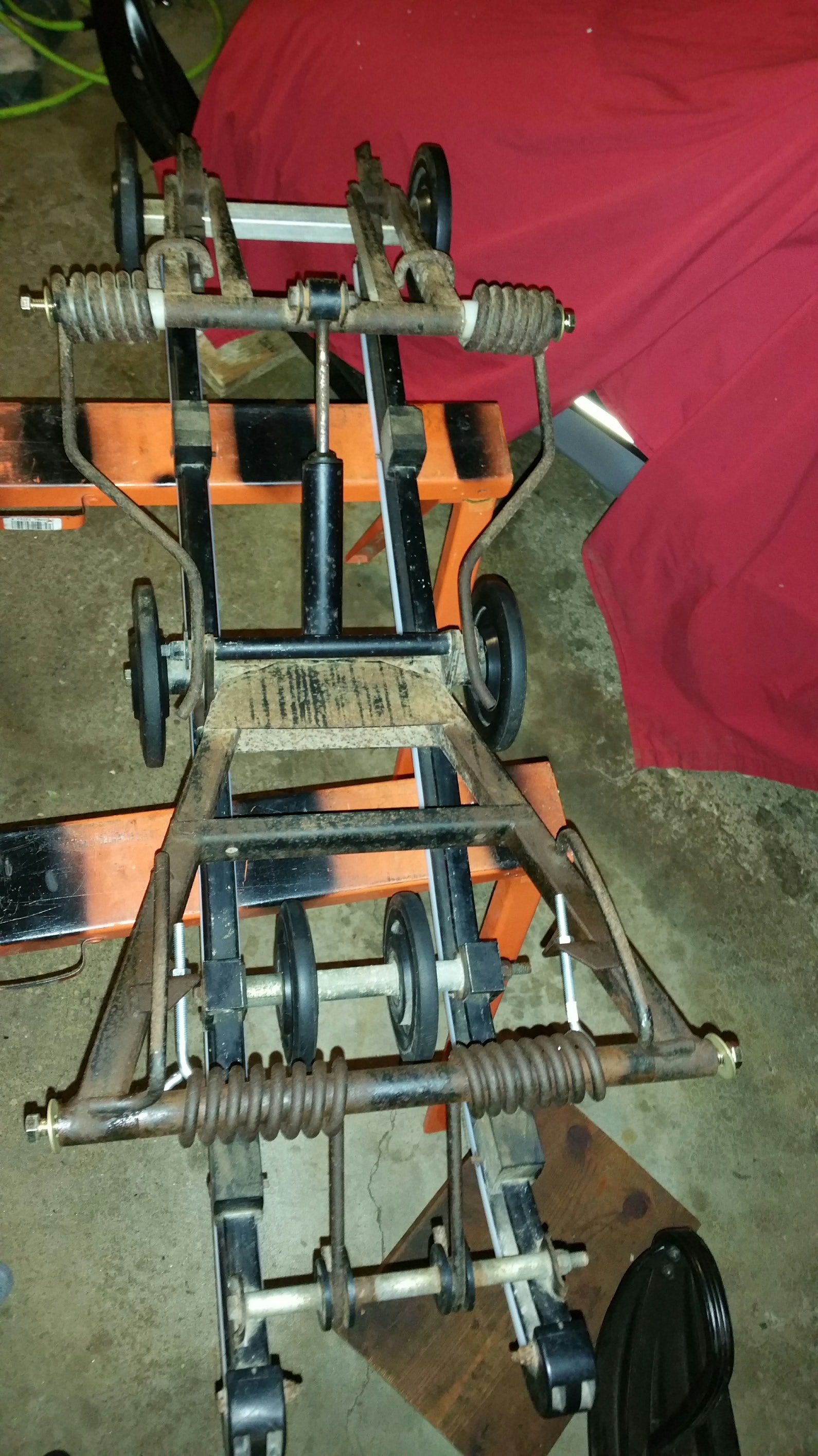

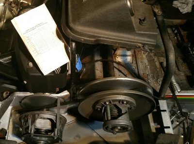

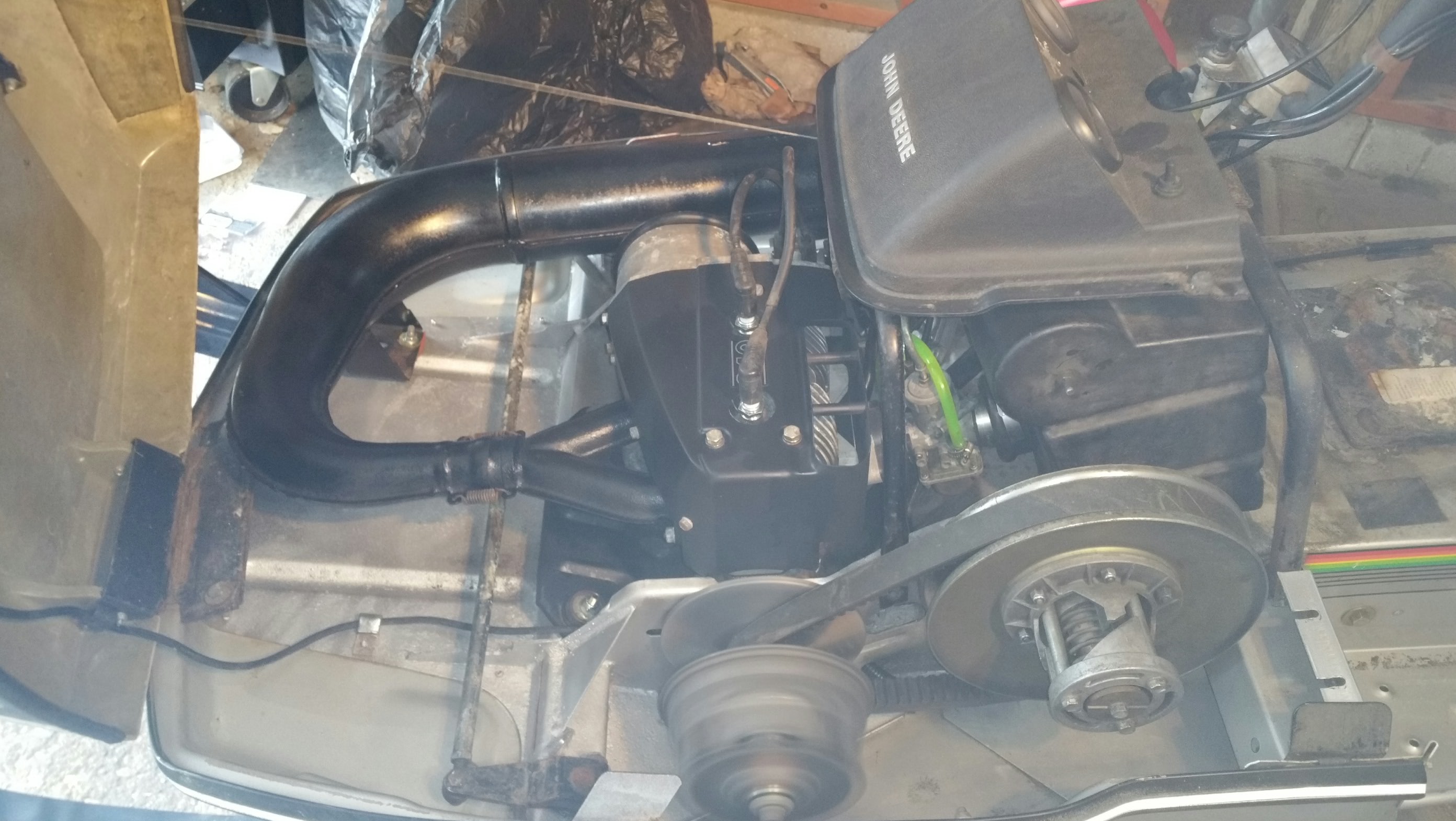

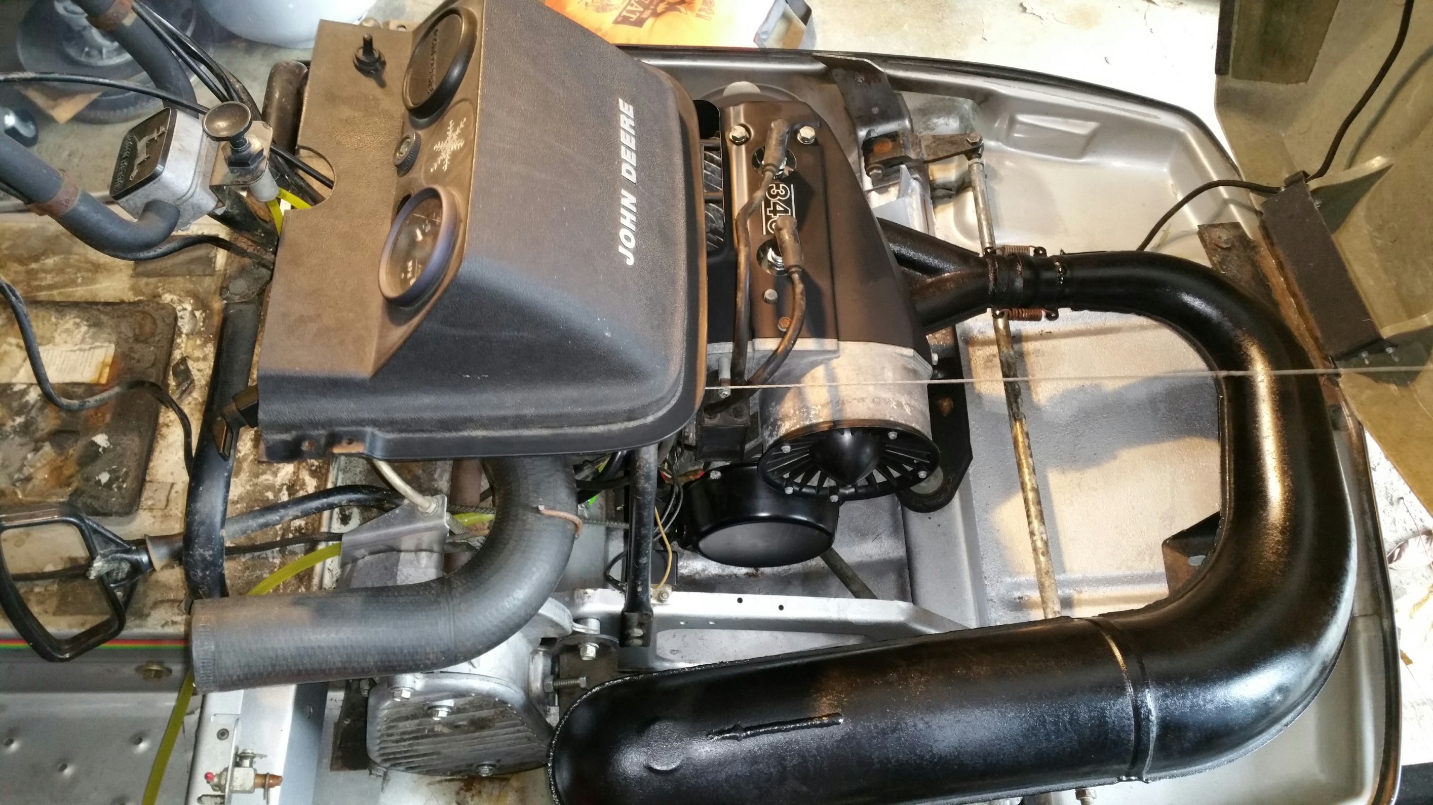

The Canadian special suspension came reinforced from the factory. Freshened it up and installed it, clutches were freshened up and aligned. Motor was rebuilt with new spi pistons and new gaskets and seals. Secondary shaft and drive shafts pulled and new bearings installed. Chaincase got new cork gaskets and a new rubber seal. Fuel tank was flushed. Still some small things to finish but getting towards the end finally!
Fired her up today, so good to here em pur after all that work! Went with a standard clean 340 carb on it, no primer outlet simply cause it was ready to go and well I'm low on time! Couple small things to button it up like mount tank and seat and windshield, wearbars, fan scoop, etc.
