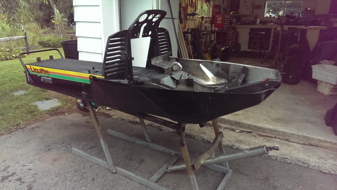

I decided to tape off the decals and paint the tunnel and pan. I didn't put much prep work into it but it came out pretty good. Also de-studded the track today (it was studded for a 650 triple w/ pipes). I've got all the parts needed to rebuild the Polaris suspension lined up. I found a crack in the original chaincase, so I've got a roller 80 Liquifire chaincase to go in from JDRob. Rob also sent a set of handlebar controls for it from a Trailfire, as I didn't want to use up a set of hard-to-find '78 controls since it's a trail rider.

The paint turned out pretty decent. It will be neat to see complete.
