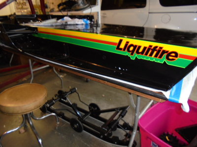

In every restoration the most stressful part to me is installing the graphics. There's just no margin for error. Knowing that I only use Mark Olan's AFE Graphics (jdsleddecal.com). It's still stressful but at least I know the product is good. Thanks Mark!!

I agree Don, I get nervous just putting on yellow stripe! The big decals you are putting on would freak me out! They look great once they are on though!

Those turned out very nice DA

Looks great DA.

Decals are a challenge but it looks darn good from this angle!

Marks decals are great. A few years back I sent him a pair of NOS tunnel decals for the 83 Sportfires. He repopped them, sent me a set, and returned the originals for a great price. We both got what we needed. I'd like to hear about everybody's techniques for applying hood decals. I had one hell of a time with wrinkles where the bump out in the hood is.

I've had pretty good luck floating them on with Windex. I use a light mist of Windex on the hood, lay on the decals, then squeegee out the Windex with a body filler applicator. The original formula with ammonia works best.

BTW that's one sweet looking tunnel. Can't wait to see the rest of the sled!
