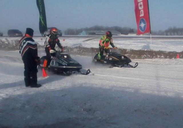

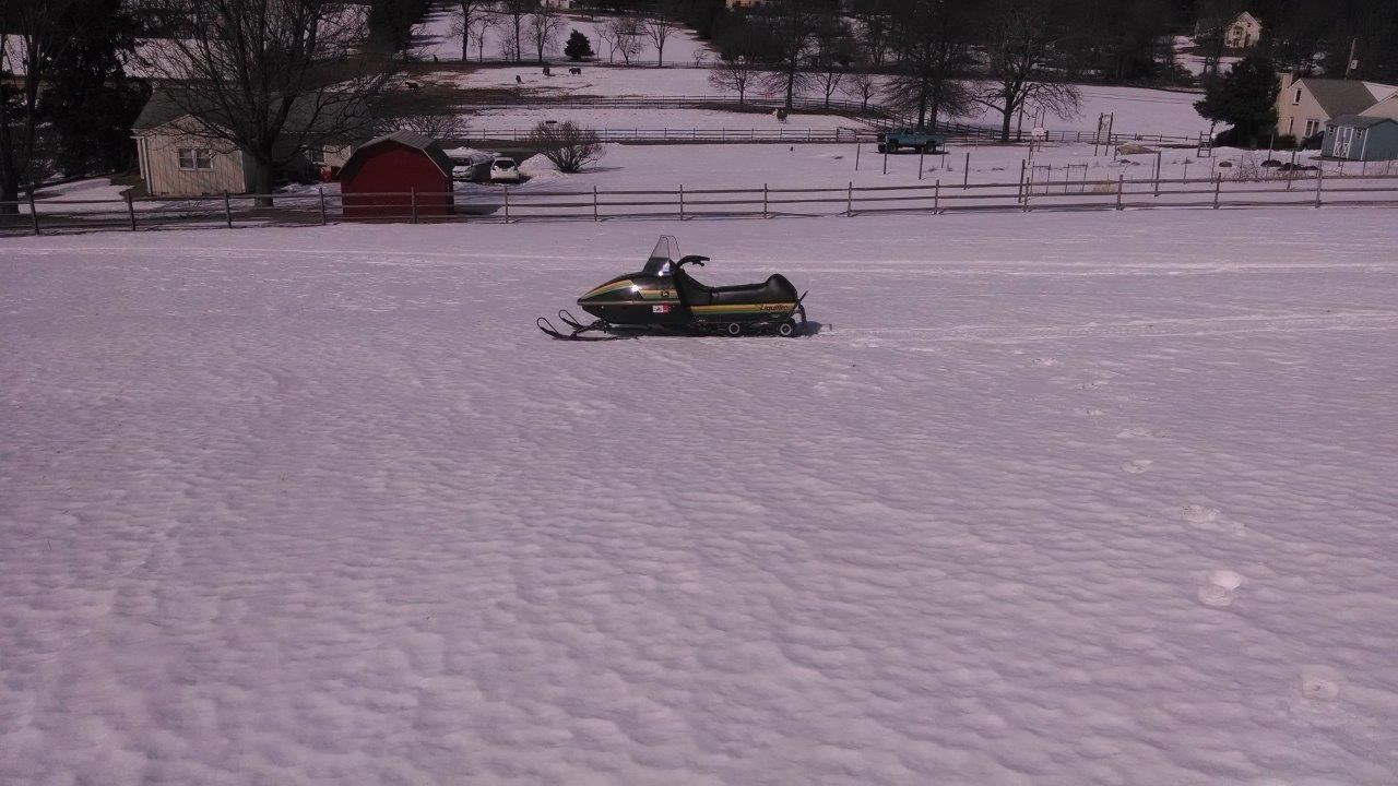

Here is the best of both generations of the Liquifires. My clone version of a '78 Cross Country. The skid is from a 1980 liquifre with a Arctic Cat all-rubber track. I have several hundred miles on it since the conversion with no problems.
