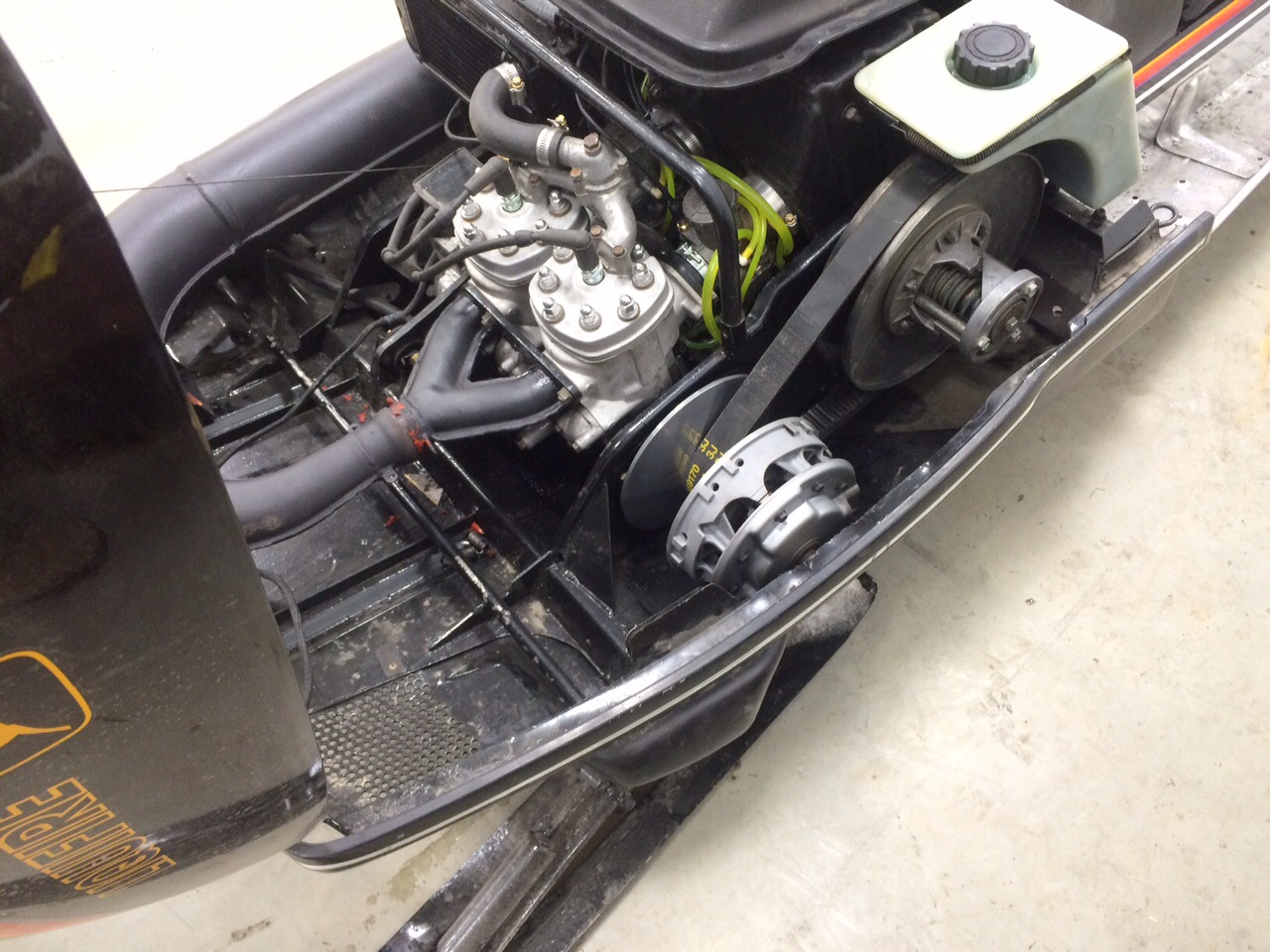

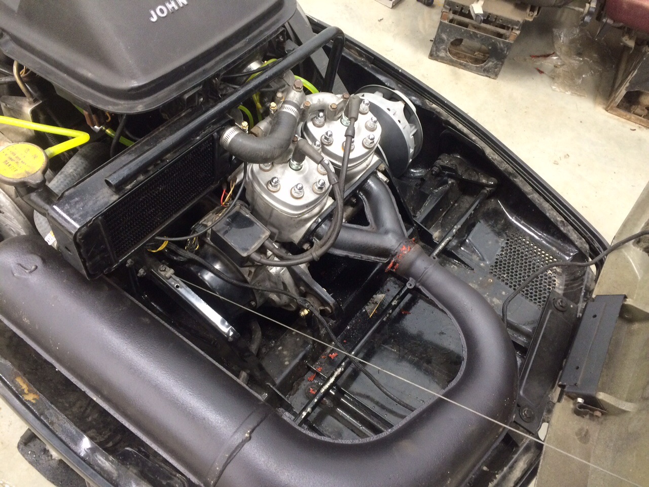

my latest project its about half done should be done in a couple of weeks hopefully we will have some snow to try out

I just got my 83 finished on Christmas eve. I just have to put the new windshield on and bolt down the seat. I really enjoyed working on this sled this year. I will post a few pics of the finished product soon. Don't mean to hijack your post, but I like the painted motor, maybe we can get them togather sometime. Later Lincoln

Are those invader jugs and heads? And what ignition is that? Lincoln
Re: 83 liquifire restration
hi Lincoln they are stock jd heads and cylinders cdi box is a reman from image

I like the black accents
