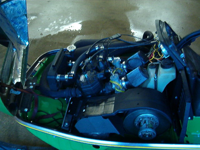

my setup is in my liquidator clone. i retained the factory offset and c to c dimensions for the 76 Liquifire its built off of. Has a 650 wildcat eng with 108 primary. I did the RWTC poker run and swamp challenge this yr with no problems. Apparently i haven't taken any pics since i installed the roller secondary.
This is a pic with the jd secondary shimmed for the 1 3/8" belt.

Again, thanks to everyone for all the tips and I love your Dator clone, JDXspec.
I got the Liquifire today and it does have a TR800 driven clutch with the taller towers so I will use that in conjunction with a Polaris P85 primary and a 1 3/8" belt. I was seriously thinking about going the Cat jackshaft route if my search for the JD TR800 driven didn't pan out.
