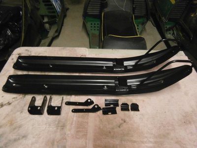

I am still working on the X-8 for next year, when I can sneak out to the shop. The NOS skis, shock brackets, and used hinge and motor cover brackets were all sandblasted and powder coated. We brought an NOS ski to the coaters to get the best match we could to the original version of black.

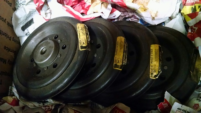

Also had some good luck, with lots of help from Brock, Jamie, and Matt from NY with tracking down a full set of NOS bogies. 4 more NOS steel bogies showed up last week, giving me a complete set for the sled.
NOS Bogies
NOS Bogies

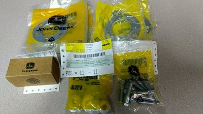

My next parts order arrived from Deere last week. When I went into the local Fort Worth dealership the new guy behind the parts counter asked me if I was the "snowmobile guy". I asked him if I beat the pre-season rush! Turns out he was from Colorado and knew a little about Deere sleds.
Most of the parts there things I ordered previously, like bogie bolts and washers. But I was also able to purchase all new bearing flanges for the drive axle and upper chaincase. I will of course compare them to the originals to verify the fit.

New Parts from Deere

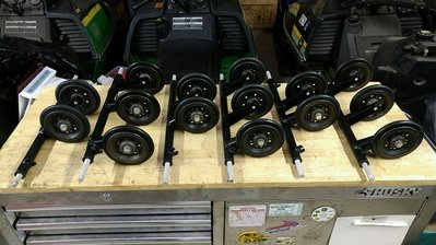

The drive and rear axles are already assembled, and now all 6 sets of bogies are now complete. Each wheel had the dust caps removed and a shot of fresh grease squirted behind the seals. The cross tubes are NOS also, but were blasted and powered coated flat black. The cross shafts were used except for one, but all 6 were replated. Luckily I found I had a few sets of NOS bushings, but they were the update black nylon style vs. the original red rubber units. I am pretty happy with the end result at any rate.
NOS Bogies Assembled

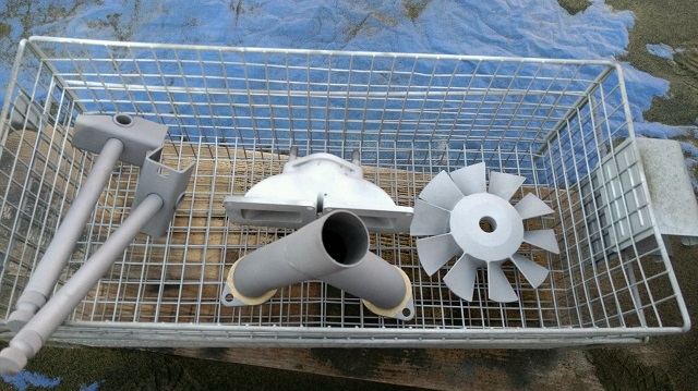

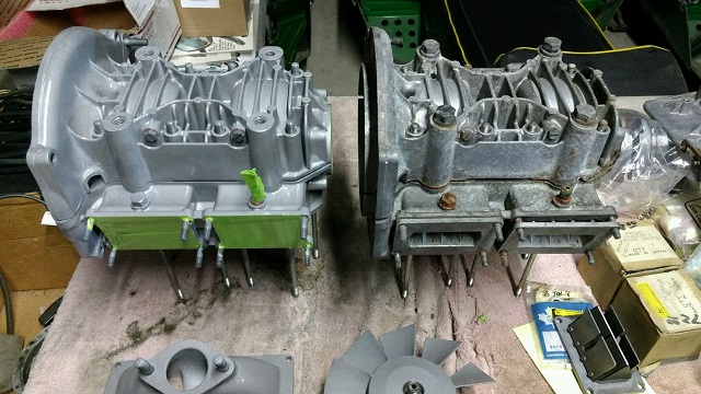

First up was doing a little cleaning and sand blasting on some of the engine pieces and smaller chassis parts that needed it. Once the aluminum castings were degreased, they still looked pretty cruddy, so I blasted them as shown. But, based on prior experience with bead blasting, without sealing the surface, they go back to looking old and corroded all too soon. Note that I used low pressure and recycled abrasive as not to be to hard on the aluminum, and I kept the cases bolted together to protect the flat sealing surfaces.
So I tried some clear engine paint on the intake manifold, figuring if it looked bad it would be easy enough to blast off and paint with aluminum cast colored rattle can if needed. Turns out I liked the effect of the clear, and engine paint should stand up to gas and oil reasonably well. To show the effect, the pic is the set of cases I sand blasted and cleared vs. a set I degreased and cleaned with brake parts cleaner.

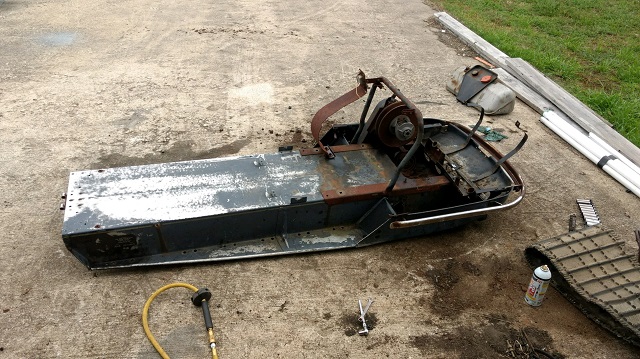

So we are both back to nudging progress on our X-8's. As for my story, it was this fall I figured out that my chassis just wasn't nice enough to justify powder coating. The belly pan patches looked "ok" for a rider, but it was not going to looks as nice as the rest of the parts that were going to be bolted to it.
A text message out to the guys yielded a response from Wade Bennett. He had a tunnel with a better pan than mine and could bring it up to the HoF for me. Turns out it was pretty much a rolling chassis, that despite years outside, still rolled. Once back to TX, the tear down commenced! (And a big thanks to Wade!)
The Doner Sled
The Doner Sled
The New Chassis
The New Chassis

The fan tower is one more part that is completed. It was blasted and then clear coated with engine paint while the chassis work was going on. This was the same process that was used on the cases, with the same results.
As Allen noted above, it's quite an improvement in appearance for only painting it with VHT engine clear. Thanks for the compliment also Allen. :beers;
The housing is now ready to have the fan bearings and fan re-installed.
