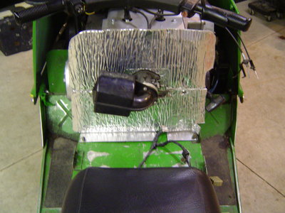

Insulation is then applied to the other two halves of the shield.
The insulation is cut about an inch larger than the aluminum shield, to seal against the plastic engine cover. I did this on the X8 years ago, and it has worked well. On the reed inducted engines, the carb sits farther away from the engine, and the insulation is simply formed around the carb flange to seal things up. On the piston port engines, the shield is well behind the carb flange, so they made the small plate to kinda fill the hole. I added strips of insulation to the back side of the shield to further fill in the gap. In '75 they went to a much more air tight and elaborate shield.
As soon as I get everything finished up, I still have to attach the lines and cables to the carb, and wrap the lines with insulation where they pass under the engine, I'll be all set to try the machine out. If all this doesn't fix the problems, I'll be a bit at a loss to know what to do next.

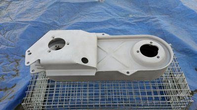

With time running short before the RWC, I am trying to make some progress on the JDX-8 project. The NOS chase case was pretty scuffed up so I blasted the outside of it and hit it with VHT Epoxy rattle can. She is ready to have the upper bearings and shaft assembled now.

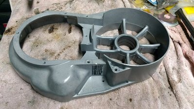

The fan tower is one more part that is completed. It was blasted and then clear coated with engine paint while the chassis work was going on. This was the same process that was used on the cases, with the same results.
As Allen noted above, it's quite an improvement in appearance for only painting it with VHT engine clear. Thanks for the compliment also Allen.
The housing is now ready to have the fan bearings and fan re-installed.
