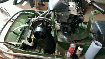

I pulled the bodywork to get a better look at the massive 28 hp, 340cc motor. I figured if I can get her running first, then I can justify moving onto the chassis. The plug wires were MIA, so I raided the NOS stash for new ones and got new plugs locally. I ordered new crank seals from Matt's "New Breed" store to backfill the ones I 'borrowed' from the JDX-8 project.
As I feared, there was no spark once the new wires were installed. So I changed the external coils with new ones. Still no spark. Called Lindner. He suggested cleaning the points before going to far with the stator. That was a good idea it turns out, but I decided to change out the crank seals, fan bearings and fan belt while I had the motor apart. I was glad I had all those goofy old JD sled tools, as it turns out I had the Salsbury clutch holding tool. But I had to borrow the puller bolt from Lindner.

Pulling the Sally
Pulling the Sally

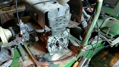

The clutch was pulled and then the fan side of the motor was stripped down, including the recoil, flywheel, fan tower, stator, backer plate, etc. Once all that was removed the crank seals could be removed and the crank ends polished. A thin film a sealer was applied around the case openings and a light film of oil was applied to the crank ends before the seals were tapped into place.

New Crank Seals
New Crank Seals

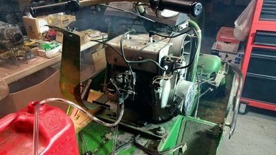

To keep progress rolling, I cleaned the points, then installed the stator and flywheel. I loosely installed the fan tower and recoil so I could check for spark and attempt to fire the motor. With the new external coils and plug wires installed, she had nice bright spark this time.
By running fuel lines to a gas can, I bypassed the fuel tank and was able to fire the motor. After the initial prime, she would then start on one pull. I took that as a good sign, called Lindner to share the news and planned to tear into the powertrain next. I started tearing into the sled on Friday January 13th. I had the seals replaced and the motor running by Sunday the 15th.
Game on at this point.

Test Fire Set Up
Test Fire Set Up

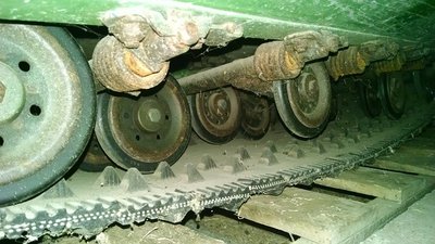

Next, I moved onto stripping down the chassis and pulled out all the bogie assemblies. Most all the bolts came out with little issue, and the hardware was generally in good shape. The front tube was pretty bent, and the another was pretty rusty, but none of the springs were broke.

Thank God I had a good stash of used and NOS bogie sled parts to raid, or I would have been screwed. In the storage barn I grabbed a mint track with the updated reinforced edge. On the parts shelves I found I had another NOS 1 1/8" drive shaft for the bogie sleds, as I had already used one for the JDX-8. The original 1" shaft and sprockets were going in the scrap bucket. Also found that being a pack rat pays off as I had 3 used 340/s track drivers, of which 2 looked useable.
The bogie tear down yielded the expected results: half were toast. Half might be salvageable with a shot or two of grease behind the seals and one or two of the cross tubes were in rough shape. Luckily I had NOS cross tubes and a pile of used bogies left over from the JDX-8 project, plus some I bought from a dealer that thought they were "NOS". You can see the PN painted on those...
