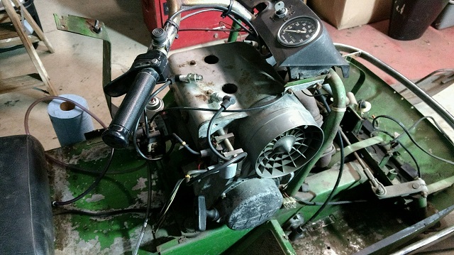

I pulled the bodywork to get a better look at the massive 28 hp, 340cc motor. I figured if I can get her running first, then I can justify moving onto the chassis. The plug wires were MIA, so I raided the NOS stash for new ones and got new plugs locally. I ordered new crank seals from Matt's "New Breed" store to backfill the ones I 'borrowed' from the JDX-8 project.
As I feared, there was no spark once the new wires were installed. So I changed the external coils with new ones. Still no spark. Called Lindner. He suggested cleaning the points before going to far with the stator. That was a good idea it turns out, but I decided to change out the crank seals, fan bearings and fan belt while I had the motor apart. I was glad I had all those goofy old JD sled tools, as it turns out I had the Salsbury clutch holding tool. But I had to borrow the puller bolt from Lindner.

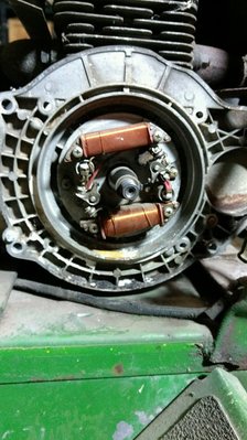

The clutch was pulled and then the fan side of the motor was stripped down, including the recoil, flywheel, fan tower, stator, backer plate, etc. Once all that was removed the crank seals could be removed and the crank ends polished. A thin film a sealer was applied around the case openings and a light film of oil was applied to the crank ends before the seals were tapped into place.
Re: Bogie Bash Sled Slam
While re-assembling the fan side of the motor, we found one of those little nuances of the 72-73 motors. The fan bearings are smaller on that era 400 compared to the rest of the CCW/Kioritz motors. Ironic part is that I have a bucket full of NOS bearings used on the rest of the motors, but they do not fit the 72 400's. So I had to order new bearings for the fan, but I needed to test fire the motor.
To keep progress rolling, I cleaned the points, then installed the stator and flywheel. I loosely installed the fan tower and recoil so I could check for spark and attempt to fire the motor. With the new external coils and plug wires installed, she had nice bright spark this time.

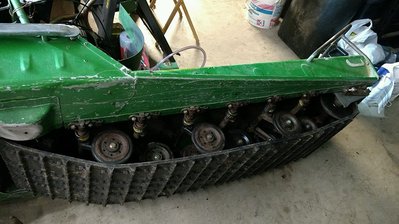

Next, I moved onto stripping down the chassis and pulled out all the bogie assemblies. Most all the bolts came out with little issue, and the hardware was generally in good shape. The front tube was pretty bent, and the another was pretty rusty, but none of the springs were broke.

Thank God I had a good stash of used and NOS bogie sled parts to raid, or I would have been screwed. In the storage barn I grabbed a mint track with the updated reinforced edge. On the parts shelves I found I had another NOS 1 1/8" drive shaft for the bogie sleds, as I had already used one for the JDX-8. The original 1" shaft and sprockets were going in the scrap bucket. Also found that being a pack rat pays off as I had 3 used 340/s track drivers, of which 2 looked useable.

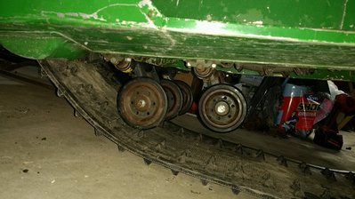

The bogie tear down yielded the expected results: half were toast. Half might be salvageable with a shot or two of grease behind the seals and one or two of the cross tubes were in rough shape. Luckily I had NOS cross tubes and a pile of used bogies left over from the JDX-8 project, plus some I bought from a dealer that thought they were "NOS". You can see the PN painted on those...

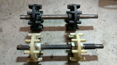

As mentioned above, the rear axle came apart quite easily, even the inner bushings came out. But the bolts got a bit chewed up when I got carried away with the impact gun. Luckily I had NOS parts to burn up on this project, including the rear axle shaft. Lindner had sent me a hardware kit for the X-8 that had duplicate sets of rear axle bolts, so they were put to use long with NOS rear springs, side plates and adjuster bolts.
Again, the oddness of the 72 got me. The rear axle bearings are unique and had to be sourced locally as the set for the X-8 had a different PN.
The front axle was made of the used 340/s drive sprockets left over from a resto, and the NOS drive axle. I did steal the drive axle bearings from the X-8, and back filled them with ordering new ones from Deere.

The bogies were all previously greased with a needle attachment on the grease gun. I had enough new JD bolts and washers left over from the JDX-8 resto to use all new hardware to bolt the 15 bogies onto the cross tubes. Two NOS tubes were uses, but all the original cross bushings and inner shafts were re-used. I did find I had another full set of NOS springs, so the they were put into use also. I figured this sled was going to ride as good as it did in 72.
