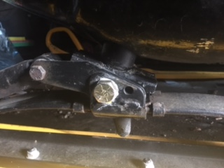

Works for me.
Works for me.
spring shackle bolt.JPG (27.87 KiB) Viewed 4136 times
I reamed out the shackle and used a 5/8" Grade 8 bolt. JRC mentioned a few years ago that they used to do this.
The result is no free play and the ski bolt probably will not break. Along with the SLT skies from newbreedparts.com it handles like a dream.
Link for the ski. https://www.newbreedparts.com/newbreed/ ... rings.html

Mark, that's a huge bolt so do you not use a bushing?

That is the point. The bushing and the original bolt is replaced by the 5/8" bolt.

Keep in mind a grade 8 bolt will shear before a grade 5 will, there is a Deere Racing Bulletin on this from back in the CC days. Although these were using the 1/2" or 9/16ths & the bushings. I personally sheared a " CAT " grade 8 - 9/16ths ( using a drilled out bushing ) bolt off on the Dator.
Grumpy
Re: 5/8" Grade 8 Ski Bolt
ICCSF 108 wrote:Keep in mind a grade 8 bolt will shear before a grade 5 will, there is a Deere Racing Bulletin on this from back in the CC days. Although these were using the 1/2" or 9/16ths & the bushings. I personally sheared a " CAT " grade 8 - 9/16ths ( using a drilled out bushing ) bolt off on the Dator.
Grumpy
I've read that's a myth. Grade 5 will bend before it breaks. Grade 8 won't bend, it just breaks, but the breaking point is still higher then a 5.
One thing that is overlooked so far is the fact that the bolt, whether 5 or 8, is harder than the steel used in the saddle so without the bushing the saddle will wear very fast. Eliminating the bushing and going with a 5/8" bolt is a temporary fix to sloppy steering.
