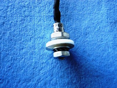

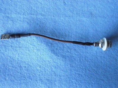

Todd, I made up some e-start rectifiers a couple of years ago. I'll post a picture. Would this help him if he found a place to mount it? It has to be mounted with plastic washers which come with it. Signed: Just Curious
