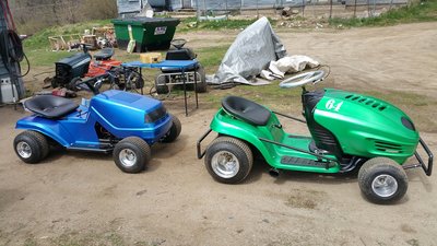

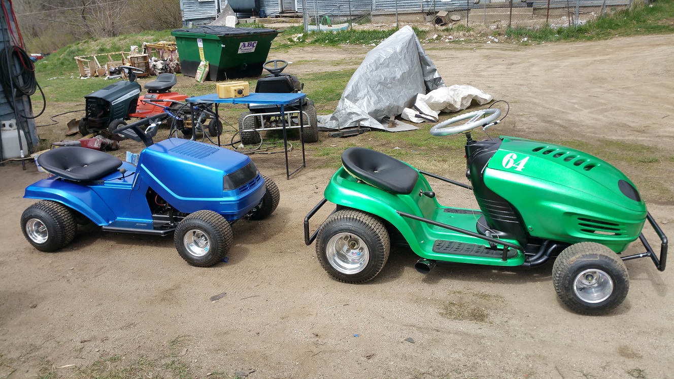

ya.no such thing as a budget when your building.loljust built these for drag racing
