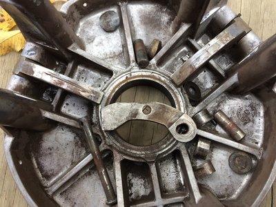

Part 2: I got the 101c off my 800 and opened up the can yesterday on the bench. Wow what a filthy mess. It has been said that this is a major reason the cans are no longer used. I cannot believe the amount of fine powder dirt/grime/carbon, whatever you want to call it.

Here's what the inside looked like after just blowing it out with compressed air. I guess that is one benefit of not having an open face, as the 102's take quite a bit of work to get clean.
Re: Comet Clutch talk
Now here is the interesting part. Take a close look at the rollers and fly weights. I was amazed at how flat spotted they were, and how the weights were completely grooved on one side and worn flat on the curved portion of the weight. The pivot pin was worn thin as well. I cannot believe I could even drive this sled with the condition of this clutch. It wore this way on all three weights. I guess this happens, but I was simply blown away that it could still work like this.

So now the work will continue to get the spider off, replace parts, and put it back together. I cleaned the can completely on the inside, and gave it a fresh coat of paint to pretty it up.
