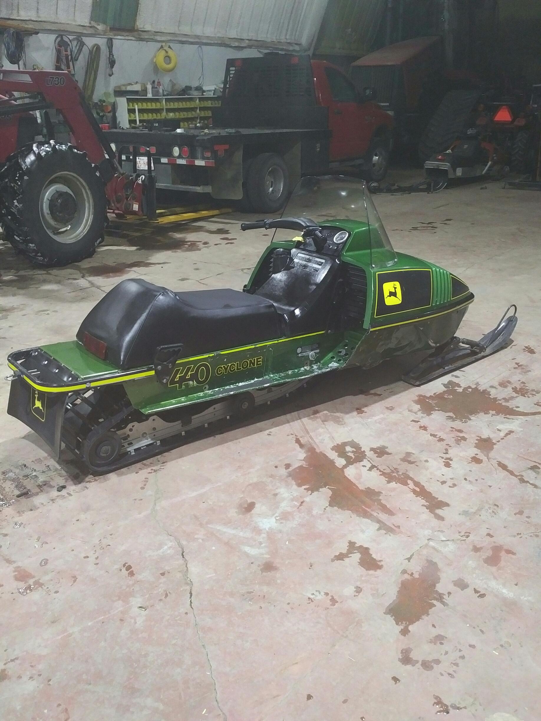

440 cyclone mod
440 cyclone mod
[attachment=0]cyclone 3.jpg Here is a mod that works very well for the cyclone 440. Installed a Polaris 136 track and M-10 Extra suspension. fit very well. The Rear extension is off a Summit 700 and rear bumper off a Polaris Mountain Magic long track. The polaris extension is to narrow to be utilized on the JD tunnel :sled:

Looks fantastic! And I bet it's fun to ride!

What drivers and drive axle are you using? Hex Shaft? Is there room for more lug at the bulkhead?
