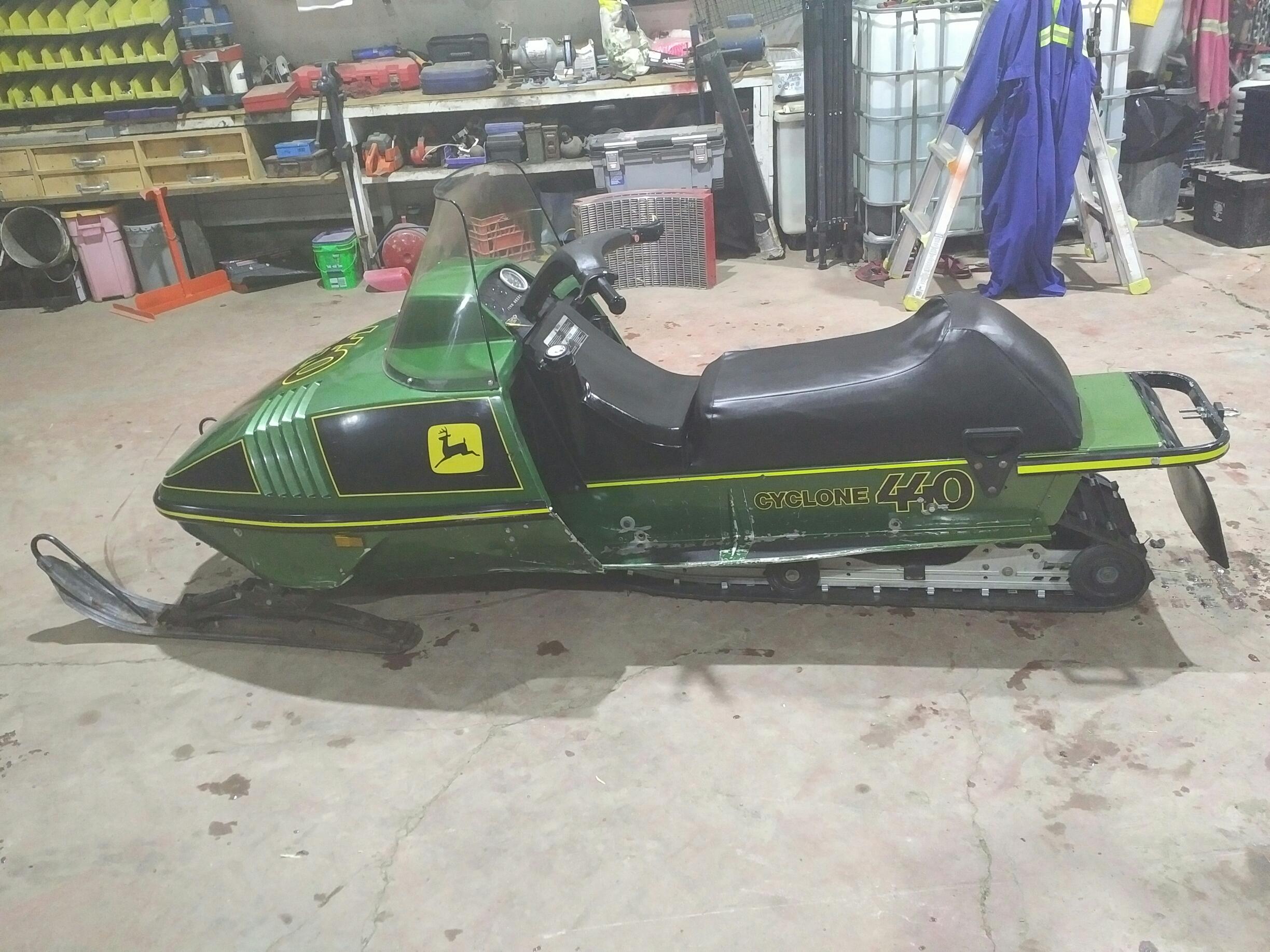

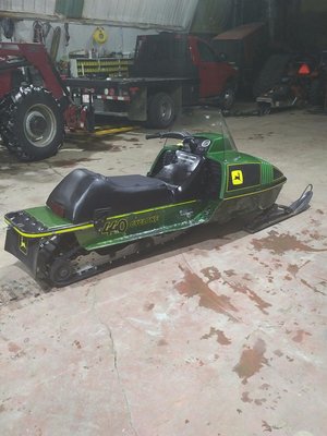

[attachment=0]cyclone 3.jpg Here is a mod that works very well for the cyclone 440. Installed a Polaris 136 track and M-10 Extra suspension. fit very well. The Rear extension is off a Summit 700 and rear bumper off a Polaris Mountain Magic long track. The polaris extension is to narrow to be utilized on the JD tunnel

What drivers and drive axle are you using? Hex Shaft? Is there room for more lug at the bulkhead?
