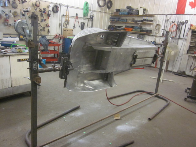

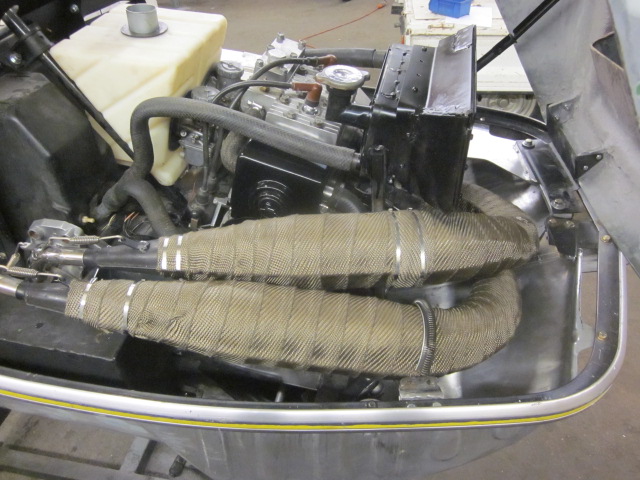

I finally am getting back to working on my Dator project which I hadn't touched since last January. I even had the opportunity to try out the John Deere sled rotisserie I bought a couple years ago. I had to build some adapters in order to use it on a bare chassis but it sure does work sweet. I have the chassis completely stripped down and have shortened up the tunnel/running board braces on the Liquifire chassis to the same height as the Liquidator braces. I straightened the dings and dents in the pan as much as I could but admittedly it will not be perfect. I did use some aluminum body filler in some spots and I sure do hope the staff doesn't chip off. I ordered some self etching primer which should be here next week and then it's time to get some painting done. I'll be putting a Rupp Nitro 440 Xenoah engine into it.

engine pic

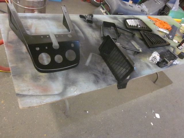

I painted a few dash related items as well as my rad support last night and they turned out fairly nice.

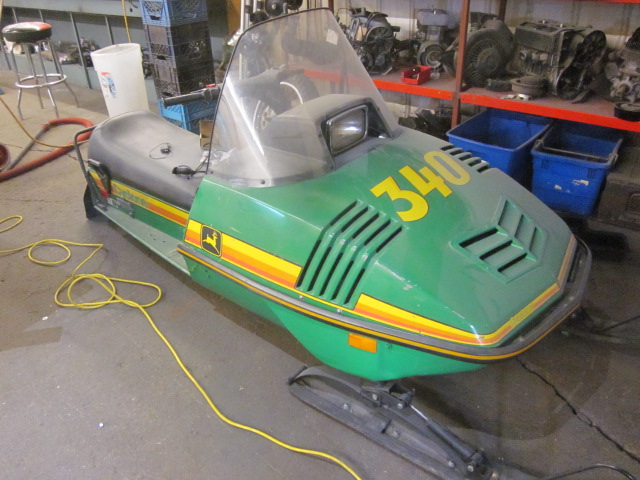

I'm grateful to have my brother for company in my shop while I'm working on this sled. He's working on his own little project right alongside me. It's a cool Swinger that he picked up at Princeton last summer. I'll attach a picture of it despite it not being a John Deere. But hey, it's green and that's got to count for something.

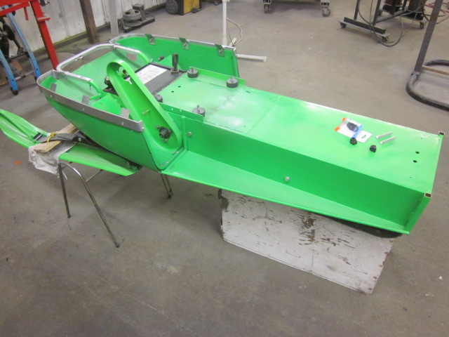

I just finished putting the first coat of self etching primer on. It's drying pretty fast. Not sure if I should hit it again with the self etch or not? Looks like the coverage is pretty decent. And no runs that I can see so far.
I absolutely love the old rotisserie. It's a kinda crude looking thing but it sure makes a job like this a bunch easier.

Hope everybody is having a great weekend. Here's what I did yesterday. Today it was too nice to work in the shop so instead I hopped on my bike and racked up 662 km. Perfect riding day for a motorcycle but I'm starting to think snow already.
