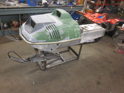

Happy New Year, everyone! I've been working on this for awhile now and I'm getting fairly close to the point where I can take it all apart and send it to the paint shop. I just have to redo the rad surround (it looks ugly) and then figure out how to trim down the tunnel support braces the way there are on a Dator. Once it's back from painting, I'll try to get it back together as soon as I can because I do want to ride this thing this winter.

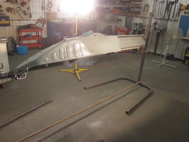

Re: Datorfire is coming along
Post by Liquifire 4/6 »

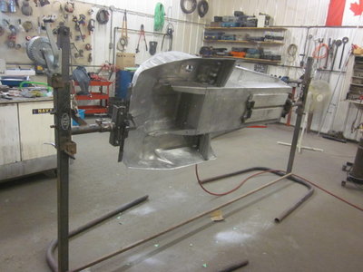

I finally am getting back to working on my Dator project which I hadn't touched since last January. I even had the opportunity to try out the John Deere sled rotisserie I bought a couple years ago. I had to build some adapters in order to use it on a bare chassis but it sure does work sweet. I have the chassis completely stripped down and have shortened up the tunnel/running board braces on the Liquifire chassis to the same height as the Liquidator braces. I straightened the dings and dents in the pan as much as I could but admittedly it will not be perfect. I did use some aluminum body filler in some spots and I sure do hope the staff doesn't chip off. I ordered some self etching primer which should be here next week and then it's time to get some painting done. I'll be putting a Rupp Nitro 440 Xenoah engine into it.

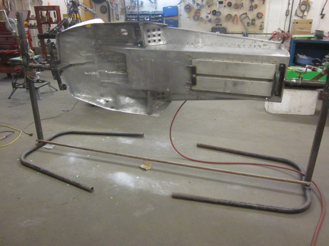

another pic

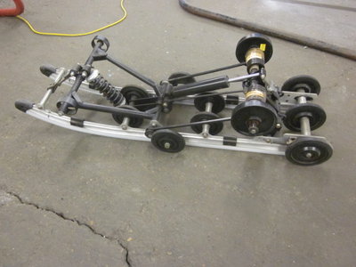

ljm wrote:That will be a fun sled.
What are you using for a track and suspension?
I am using this Polaris suspension. It's what they called the Dial-adjust suspension and it's out of a 1990 Indy Trail. I didn't want to use anything with too much travel because it would look out of place. But I wanted something with a more plush ride than the original skid.

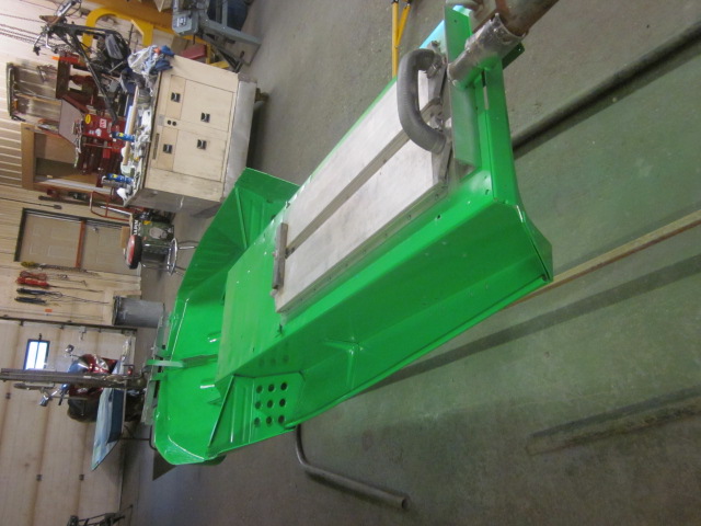

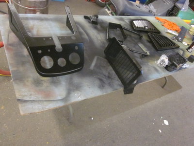

I painted a few dash related items as well as my rad support last night and they turned out fairly nice.

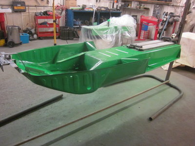

I just finished putting the first coat of self etching primer on. It's drying pretty fast. Not sure if I should hit it again with the self etch or not? Looks like the coverage is pretty decent. And no runs that I can see so far.
I absolutely love the old rotisserie. It's a kinda crude looking thing but it sure makes a job like this a bunch easier.
