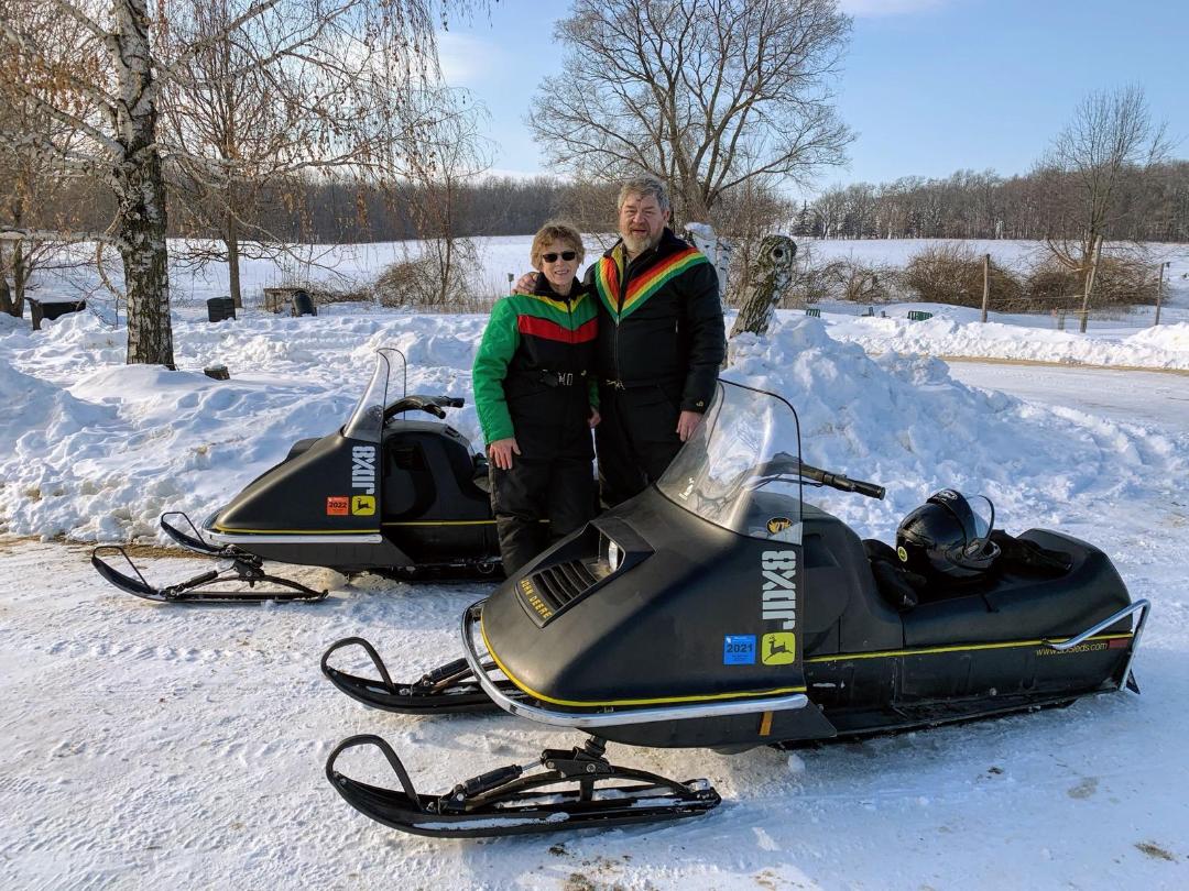

I'll throw this pic on the thread as a book end. This was taken Feb 2021, and is really the first good pic of the two sleds together.
Because of this site, and the 74 X8 I started riding in 2007, I have met a lot of good people, and have made a lot of memories. Kevin Campbell and I were reminiscing at the 2021 Round Up in St Germain about the day he stopped in and we tore the 73 X8 apart. Lots of trips, lots of rides, some truly crazy adventures, and a lot of laughs.
