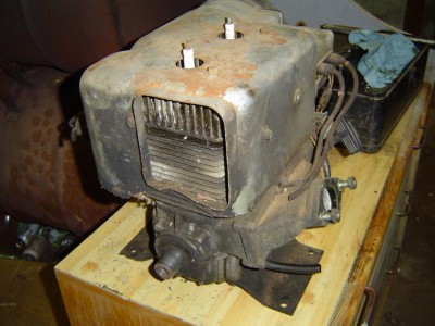

The plan for this sled is to pull the engine, take a close look through the exhaust ports, do a compression check, and if all is acceptable, I'll clean it up, replace the crank seals, and paint the shroud.
The chassis needs a good cleaning, a little rattle canning, and then the installation of NOS parts can begin. No restoration here, this will be a rider, with the wife looking forward to being the driver.

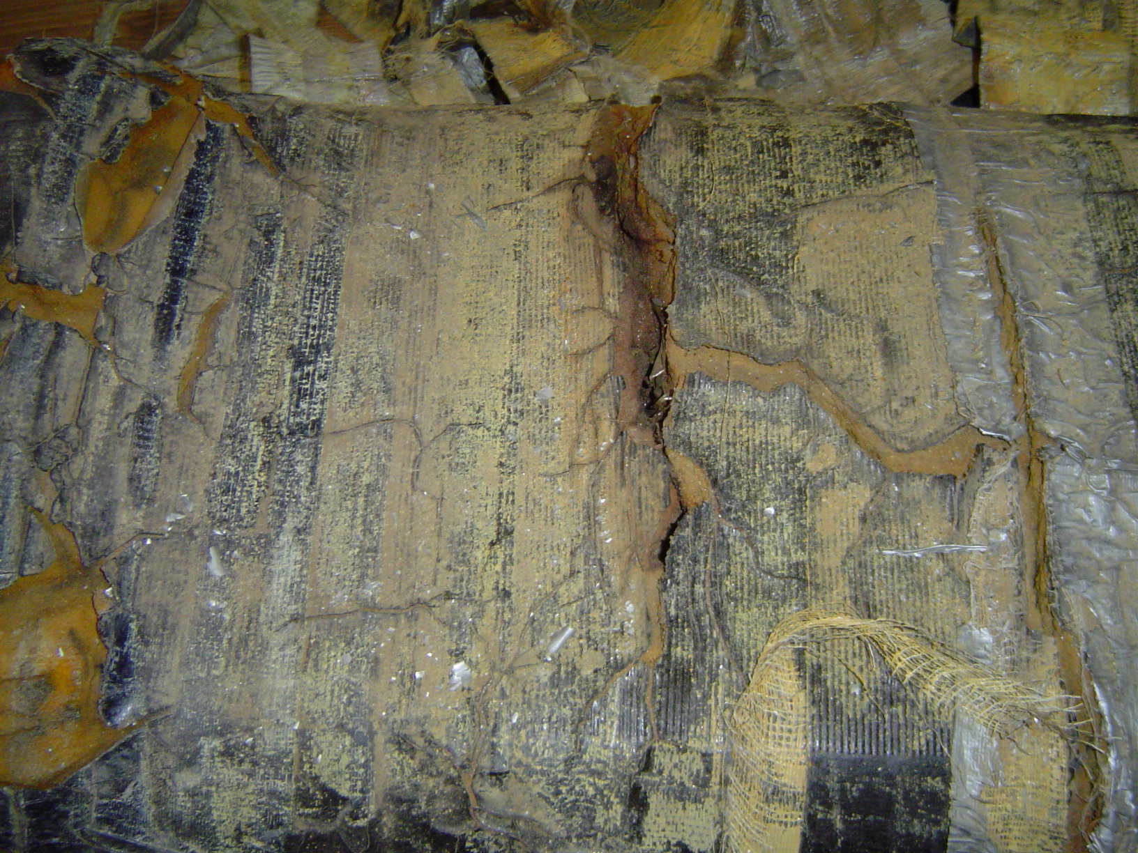

The seat on this sled is cracked down the middle ( full length ) with several across as well. Simply put, it is junk.
I had one other 00/JDX molded seat. Danzig had picked it up at Ed Meyer's place several years ago. It had been recovered with a fuzzy black fabric, but had a strange feel as to what was under it.
Katy and I were in the shed on Saturday, so we cut the cover off to see what we had. It was kind of like a Faberge' Egg, as we worked our way down through the layers. The black fabric was cut away to reveal the strange feeling surface below. The entire seat had been covered with...wait for it...Yes...duct tape!

I started pulling the duct tape off, pretty sure I wasn't going to find a pristine seat under it.
There are two cracks like that across the seat, and they are 3-4 inches deep. Not exactly a great foam to recover either. SO,...I am still looking for a recoverable 00/JDX seat foam. The wife's tender bottom may be sitting on this, so I would like a nice one.

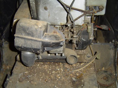

Re: The last update
Brian,
I was looking at the very first picture you posted. Is that the original hose for the air silencer? All of them I remember are "U" shaped and point straight up with the rodent screen protector. Your's looks like the glove box would choke the air getting to it? Just curious? I'm pretty sure I don't have a good seat foam but I'll check the next time I'm back in the barn.

Re: The last update
That's what the original hose looks like. The update kit included the now more familiar "U"shaped intake hose, and a new tool box.

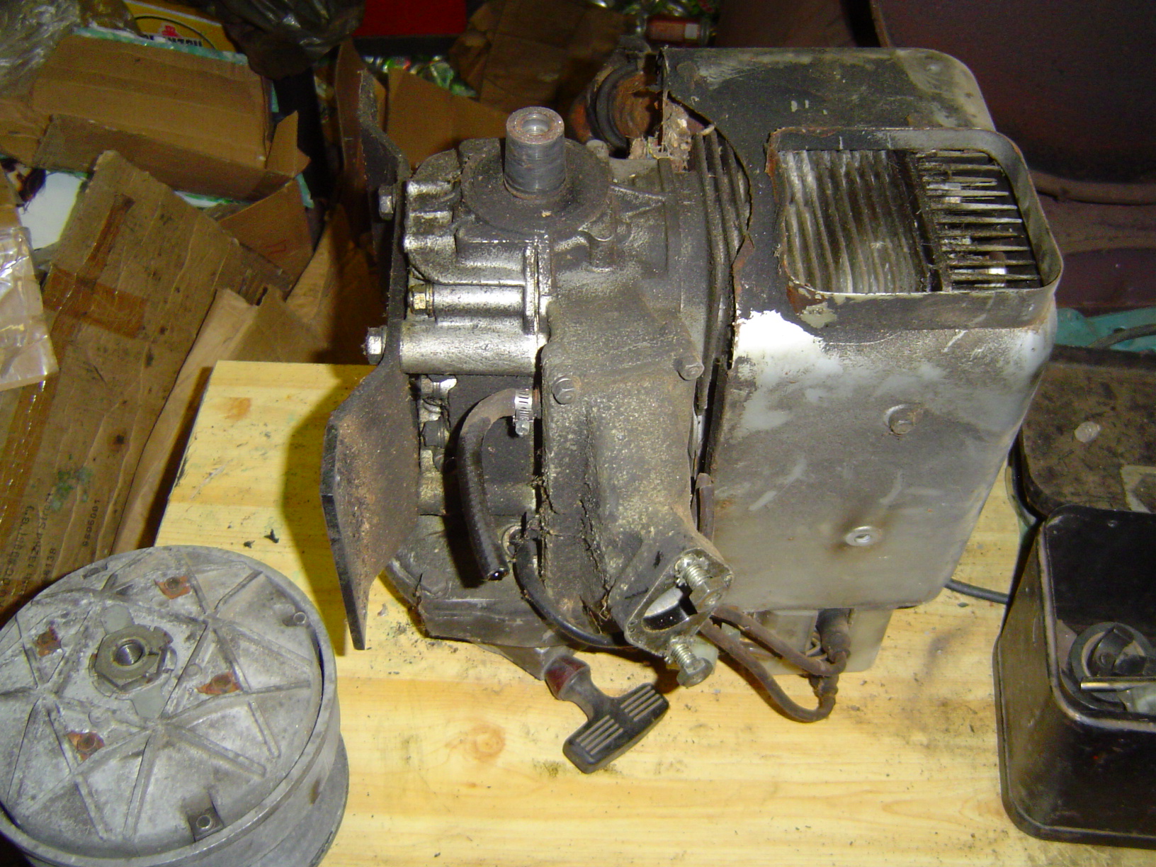

The 440/21 came out this weekend, and the Salsbury clutch has been successfully removed.
A quick compression test showed 140 on the pto side, and 125 on the mag side. A bit of oil down the weak side and it came right up to 140, so I'm pronouncing the engine good to go. Clean-up and re-seal will commence.

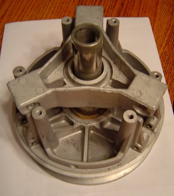

Take one typically grungy 102-C Comet clutch...hit it with a little bi-carb, and Ta...Da. Maybe not quite as good as new, but pretty nice compared to what it looked like before.

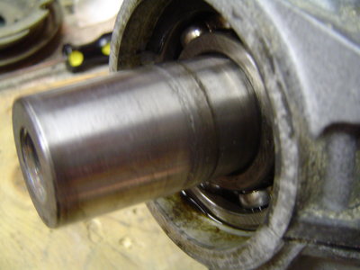

Engine has been cleaned up a bit. What a grungy SOB it was. Still not white glove clean, but I keep reminding myself that this is a RIDER!
PTO seal has been removed, never know what you'll see when its out. More than once I've found corrosion behind the seal. This one isn't too bad, but you will notice a ring around the shaft where the seal made contact. This is rough to the touch.
I'll oil up some paper towel, pack it around the bearing, clean the shaft with some solvent, then polish that area with some 400 grit. I will also try to install the new seal a bit deeper, to get onto a fresh surface. We'll see if that works.

Well, the shaft polished up without too much effort. The seal installation was scary, I had a hard time getting it to start square, then it went in hard every millimeter of the way. Can't drive it in further then before, it bottoms out. I think I've had that thought before, with the same result. By my count, this is the fourth Kioritz engine I've re-sealed without splitting the case.
The mag side shaft looked great, and the new seal had a little step in the edge that really made installation go better. It tapped in with less issue. A good job done.

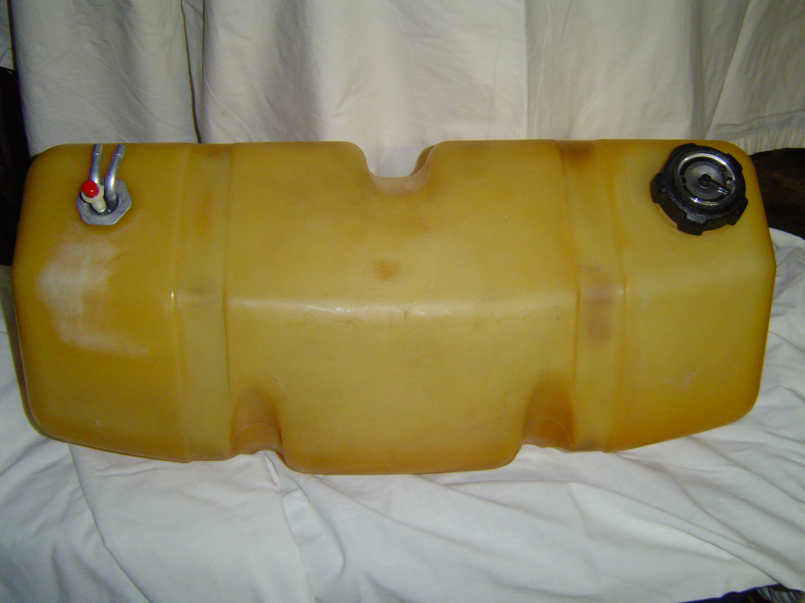

Being as this is a rider, a few functional upgrades are being made. The clutch to be used is a 102C off a '78 rather than a 100C. I actually found an NOS clutch kit, but at $600 I thought it a bit pricey.
The original gas tank has had fuel sitting in it for probably 30 years, so I opted to go with a '75 plastic tank.
Duane Gjerseth set me up with the tank, and the aluminum heat shield I needed for the vapor-lock upgrade. The tank was pretty grungy, but it cleaned up nicely with just detergent, hot water, and a chunk of chain for the inside.
JDJR provided the NOS fuel fitting, and New Breed Parts the cap/gauge, and a fuel pickup with check ball.
Thanks to all.
Thanks to all.
