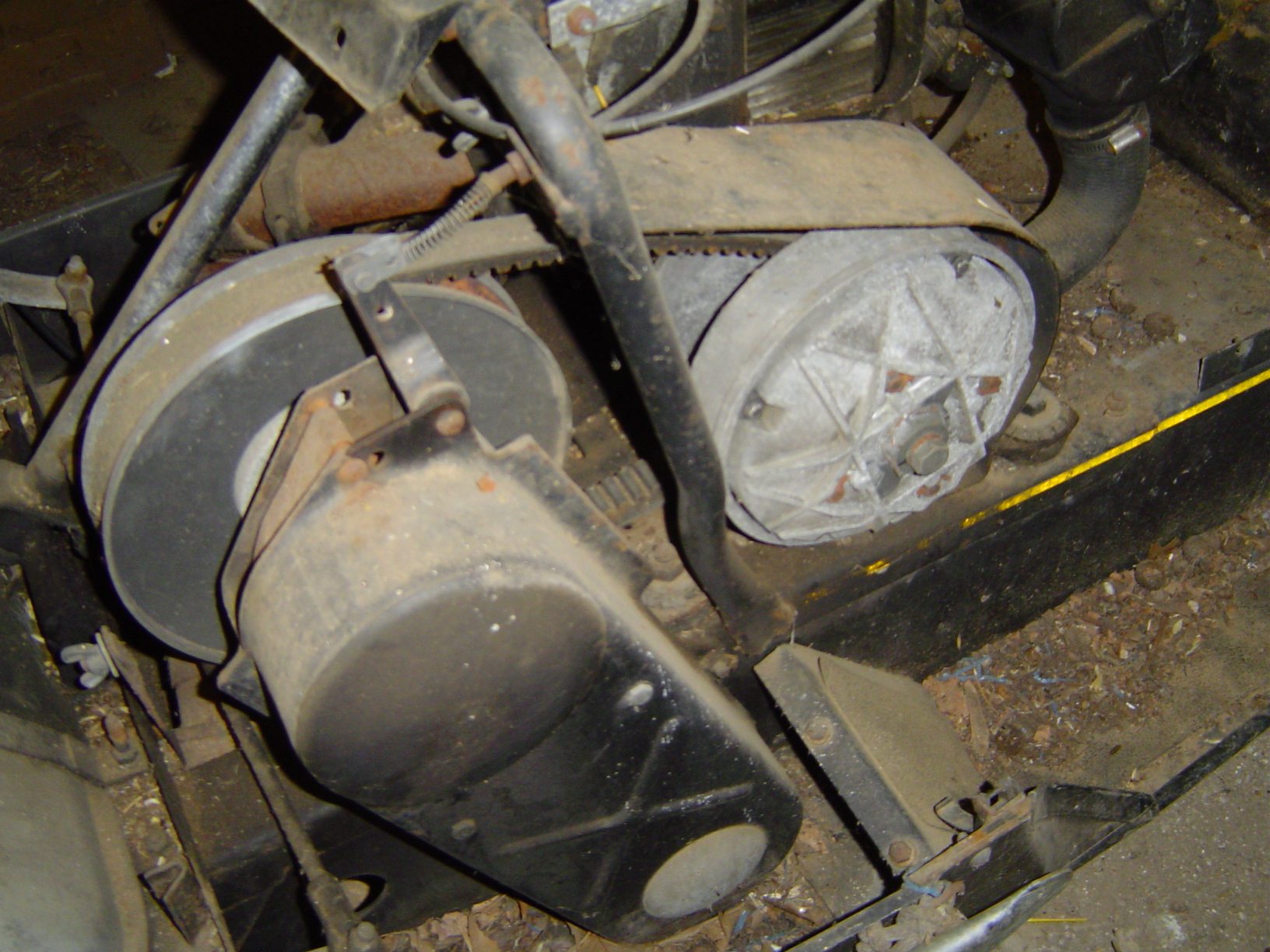

I have a '73 X8 that has been sitting in my shed for a long time. Have gathered a lot of parts for it over the years, the idea was to rebuild it for the son. But, as he couldn't care less about sleds, I had kinda forgot about it.
Then...when the JD Sled book came out last winter, one of the first things we learned was just how big a PITA the '73 sleds were, and in particular the '73 X8s.
This one is pretty much how it left Horicon. Neither the vapor lock or clutch programs were ever done on the sled.
The only updated part I have found so far is the vented spark plug access cover.

Re: The last update
According to the book, these were built in May of '72 without engines, crated and stored until later in the summer when the engines arrived. The story is that they chartered a 747 to fly them in ASAP, then set up a line and hired Horicon area school teachers who were off for the summer to finish them up.
The folks at Horicon felt like they had really pulled a rabbit out of their hat, as they had pulled the JDX program ahead a year at RJ's insistence, as he felt they needed a 40 hp sled in the lineup. The Kioritz 440/21s were a brand new design, the engineers had played with some prototypes, but they had some of the first production engines in these sleds.
Everything was great until it snowed, then the complaints started coming in from the dealers, and the factory had no solutions to the issues, as the owners were essentially the test drivers.
The sleds were fouling plugs, had an excessive fuel burn, were hard to start ( vapor lock ), belt failures, the Salsbury clutches were failing, and there may even have been some track failures. They were just a model 500 painted black, but the 40 hp engine was causing all sorts of issues. They finally held a dealer meeting in March of '73, up in Land of Lakes WI. to explain all the fixes they had come up with.
The plan for this sled is to pull the engine, take a close look through the exhaust ports, do a compression check, and if all is acceptable, I'll clean it up, replace the crank seals, and paint the shroud.
The chassis needs a good cleaning, a little rattle canning, and then the installation of NOS parts can begin. No restoration here, this will be a rider, with the wife looking forward to being the driver.
The installation of program 150 ( the vapor lock kit ) and program 160 ( the Comet Clutch upgrade ) was mandatory on all sleds in dealer inventory, and optional on customer owned machines. There can't be many that got missed like this one. I'll have to install those parts to make this a decent rider, so perhaps this sled will be the one to get "the last update".

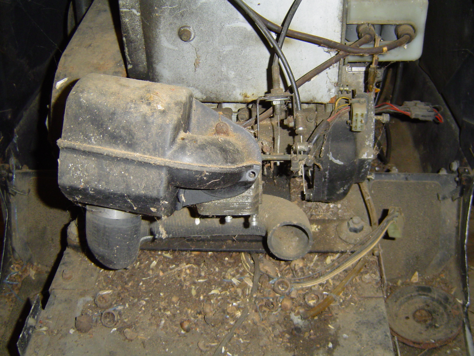

Re: The last update
Brian,
I was looking at the very first picture you posted. Is that the original hose for the air silencer? All of them I remember are "U" shaped and point straight up with the rodent screen protector. Your's looks like the glove box would choke the air getting to it? Just curious? I'm pretty sure I don't have a good seat foam but I'll check the next time I'm back in the barn.

Re: The last update
That's what the original hose looks like. The update kit included the now more familiar "U"shaped intake hose, and a new tool box.
