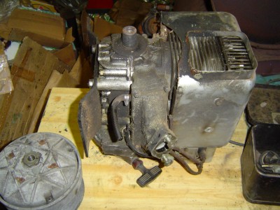

The 440/21 came out this weekend, and the Salsbury clutch has been successfully removed.
A quick compression test showed 140 on the pto side, and 125 on the mag side. A bit of oil down the weak side and it came right up to 140, so I'm pronouncing the engine good to go. Clean-up and re-seal will commence.

The flywheel came off without issue, that's always good to get behind you, and the fan shaft slid out of the bearings just like it is supposed to!

Engine has been cleaned up a bit. What a grungy SOB it was. Still not white glove clean, but I keep reminding myself that this is a RIDER!
PTO seal has been removed, never know what you'll see when its out. More than once I've found corrosion behind the seal. This one isn't too bad, but you will notice a ring around the shaft where the seal made contact. This is rough to the touch.
I'll oil up some paper towel, pack it around the bearing, clean the shaft with some solvent, then polish that area with some 400 grit. I will also try to install the new seal a bit deeper, to get onto a fresh surface. We'll see if that works.

Well, the shaft polished up without too much effort. The seal installation was scary, I had a hard time getting it to start square, then it went in hard every millimeter of the way. Can't drive it in further then before, it bottoms out. I think I've had that thought before, with the same result. By my count, this is the fourth Kioritz engine I've re-sealed without splitting the case.
The mag side shaft looked great, and the new seal had a little step in the edge that really made installation go better. It tapped in with less issue. A good job done.
