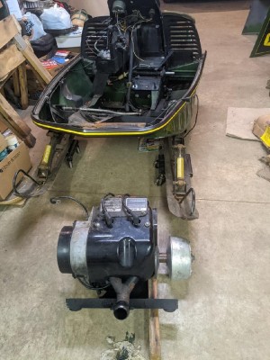

So it begins once more! The Cyclone showing 970 miles is in the garage. I see no reason to restore this one, but a bit of maintenance is required to put it back in service.
Re: Cyclones!!!
The engine showed 120 psi on both sides ( which I think I can live with ) so it is out for new seals and maybe an ignition upgrade. Need to get this thing lightened up and on it's back for some suspension work.

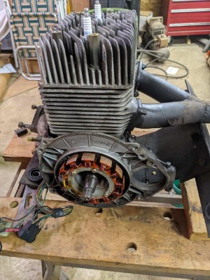

It is always good to get the clutch and flywheel off. Found a few neat things so far, like the 5/16" nuts that had been forced onto the 8mm intake manifold studs, pretty much trashing those. The starter has no nuts on the two studs on the starter flange, it is held on by the bracket on the tail of the motor, that is pretty cool! The Bosch starter requires a reduced size nut, an 8mm thread which takes a 10mm wrench, so a bit of a specialty fastener. And one stud on the exhaust manifold is bare of fasteners, might have something to do with the black goo on that side.
Showing 970 miles, I was hoping for a little less molestation.
