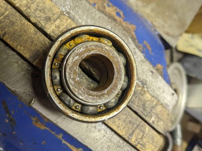

I had a set of idlers sitting on the bench that had come out of my 74 X8 a couple of years ago when I swapped in some rebuilt ones, so I went to work putting new bearings in those wheels to get the process started.
I had replaced the idlers on the X8 preventatively, I had not noticed anything wrong with them. Look at that bearing...that is why we rebuild them.
