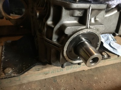

The answer on your crank seals is yes, you don't have to split the case. There's ways to pull the old one out using a drill and screws you can attach to it and pull it out. Same on both sides of the motor. To install, I've done it exactly as the Service Manual says using a solid block of wood with a large diameter hole drilled out so it fits over the crankshaft. Grease the inside well and the crank shaft (I use white lithium grease), then tap it in.... Take your time so it doesn't get cock eyed and it works good.
It may very well be the fuel system being dirty, or as Pat says, could be the ignition components. Hewtech (Scott Hewlet) makes great replacement CDI's, and they will re-wind your stator when you send him a core. Doing that and going with new coils generally has eliminated any electrical issues I've ever experienced.

Re: 1976 cyclone 440 / Kioritz 22a - great idle, lousy high end
Here's one I tapped in, not splitting the case.
