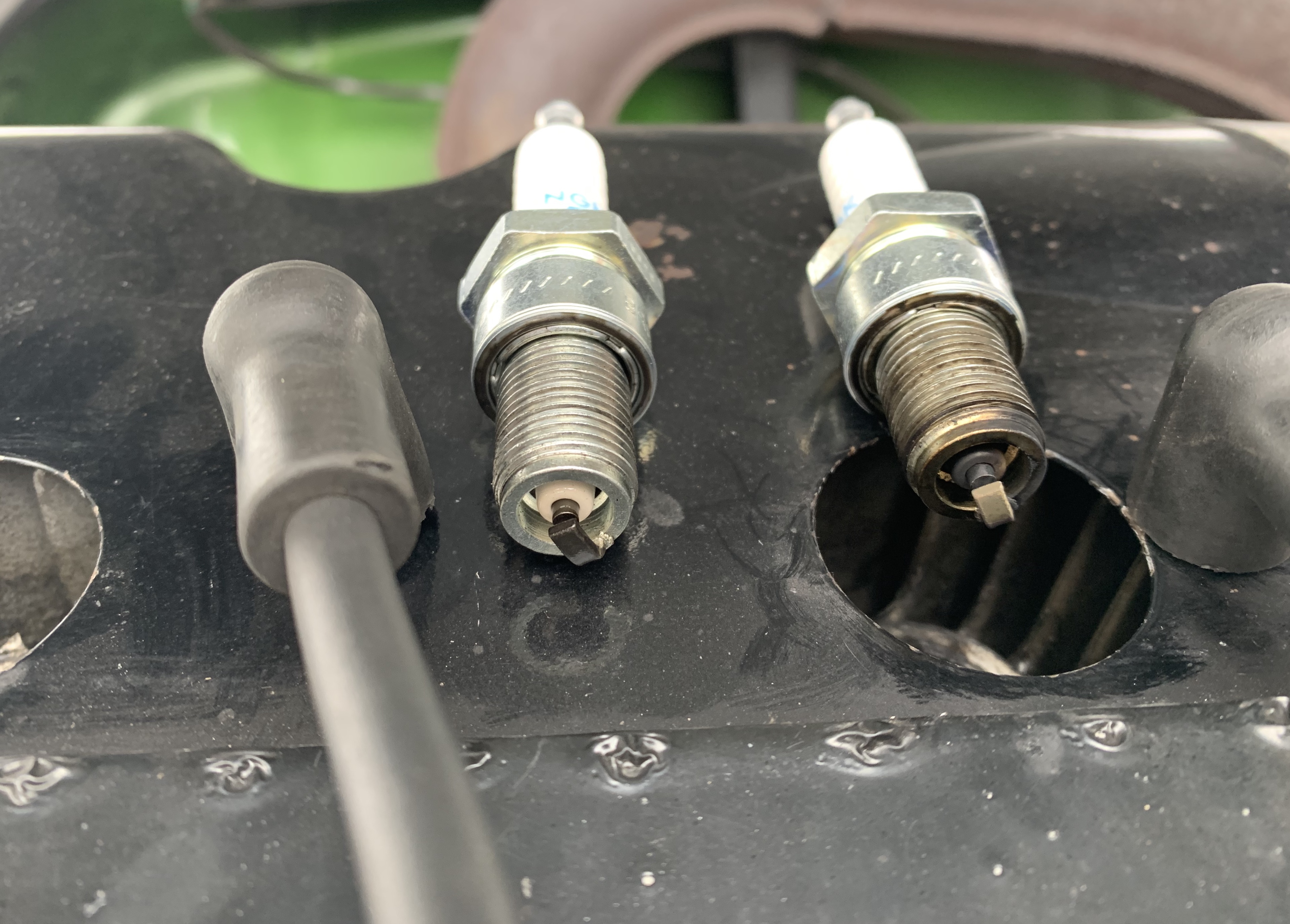

This is the 2nd year I've owned this cyclone. Starts easy (electric), idles great. When I lift the sled off the ground, I can get it to about 50+ mph.
When riding it - it hesitates at 20mph - will creep past 20mph, and eventually get up to 30. It does not sound like its bogging - it just doesn't go.
Compression in both cylinders is 125psi. Spark looks strong on both.
As a test, I put 2 new plugs in (BR9ES) today - and took it for a 15 minute full throttle ride. Pulled the plugs and found this.
The left plug is the PTO side (clean, a little wet) , the right the mag side (dark, hot).
What does this indicate? It's a single carb - all factory jets and settings applied. No - I have not changed crankshaft seals - would that cause this?

Reading plugs is difficult if not impossible. That said, Deere claims brown is proper. So the white or light tan is lean and the black one would be sooty or rich. If you have no point of reference for the crank seals you need to change them. Seals are way the Sam Hill cheaper than pistons and jugs and will eliminate that variable.

Was looking at the picture again and the visible portions of the cylinder tops and fins match the condition of each spark plug. I guess it could be spark related but only if the wires are failing because they clearly don't match. Crank seals are always an issue with a Kawasaki powered Deere versus a Kioritz but both require attention when the sled has been parked unused for even a couple years. Unmatched plug reads tend to be a dead giveaway for seal failure when all else seems normal.

AirborneX4Special wrote: Sun Jan 03, 2021 10:47 pm Was looking at the picture again and the visible portions of the cylinder tops and fins match the condition of each spark plug. I guess it could be spark related but only if the wires are failing because they clearly don't match.
Please clarify - are you saying the left fins are clean like the left plug?

If I understood the picture layout correctly, the plugs were sitting adjacent to their respective locations on the engine, so the cleaner plug was installed on the cleaner looking side and vice versa. Yes definitely swap out the coils and see if the behavior persists. If you believe or suspect that it sat several years mostly untouched I'd change those seals regardless. A compression issue would show radically differing plug reads but that's not in play since they're showing equal psi on both sides.
