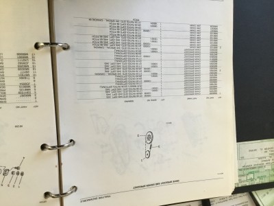

Just went to vintagesleds and nothing I can see for John Deere
Re: 340 Trailfire help
Trailfire Parts Manual Screenshot
zr870
Posts: 43
Joined: Fri Dec 25, 2020 4:00 pm
Real Name: Dave
Post by zr870 »
So gearing looks right…
Clutch weights say U on them …tan or gold spring
Just working on taking secondary apart

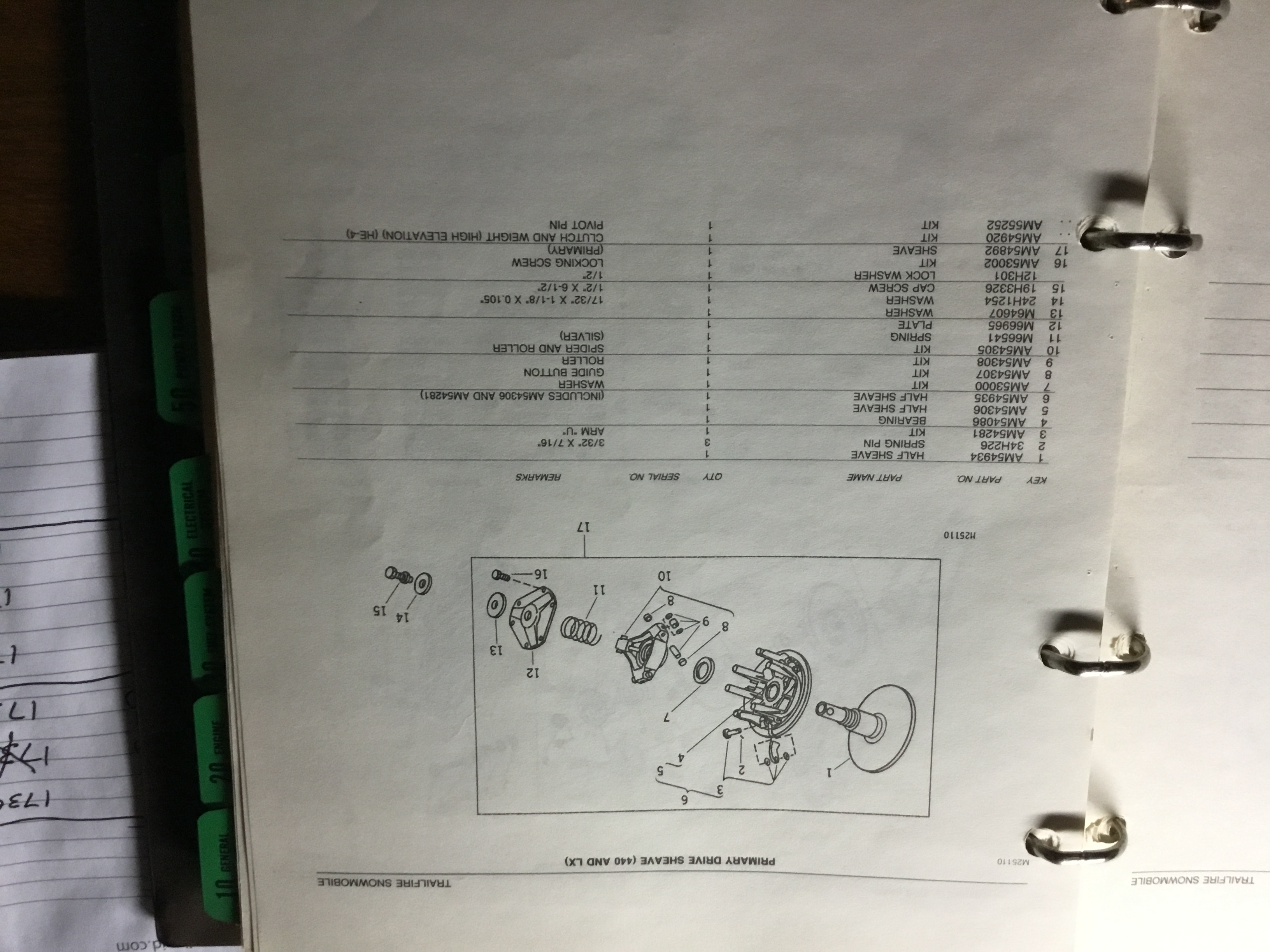

Primary clutch a Comet 102?
Primary Schematic
Primary Schematic
U cam arm is indicated with silver spring
zr870
Posts: 43
Real Name: Dave
Post by zr870 »
Yes the primary is a 102…..the weights are 61 grams
It appears you have most of the correct parts.
