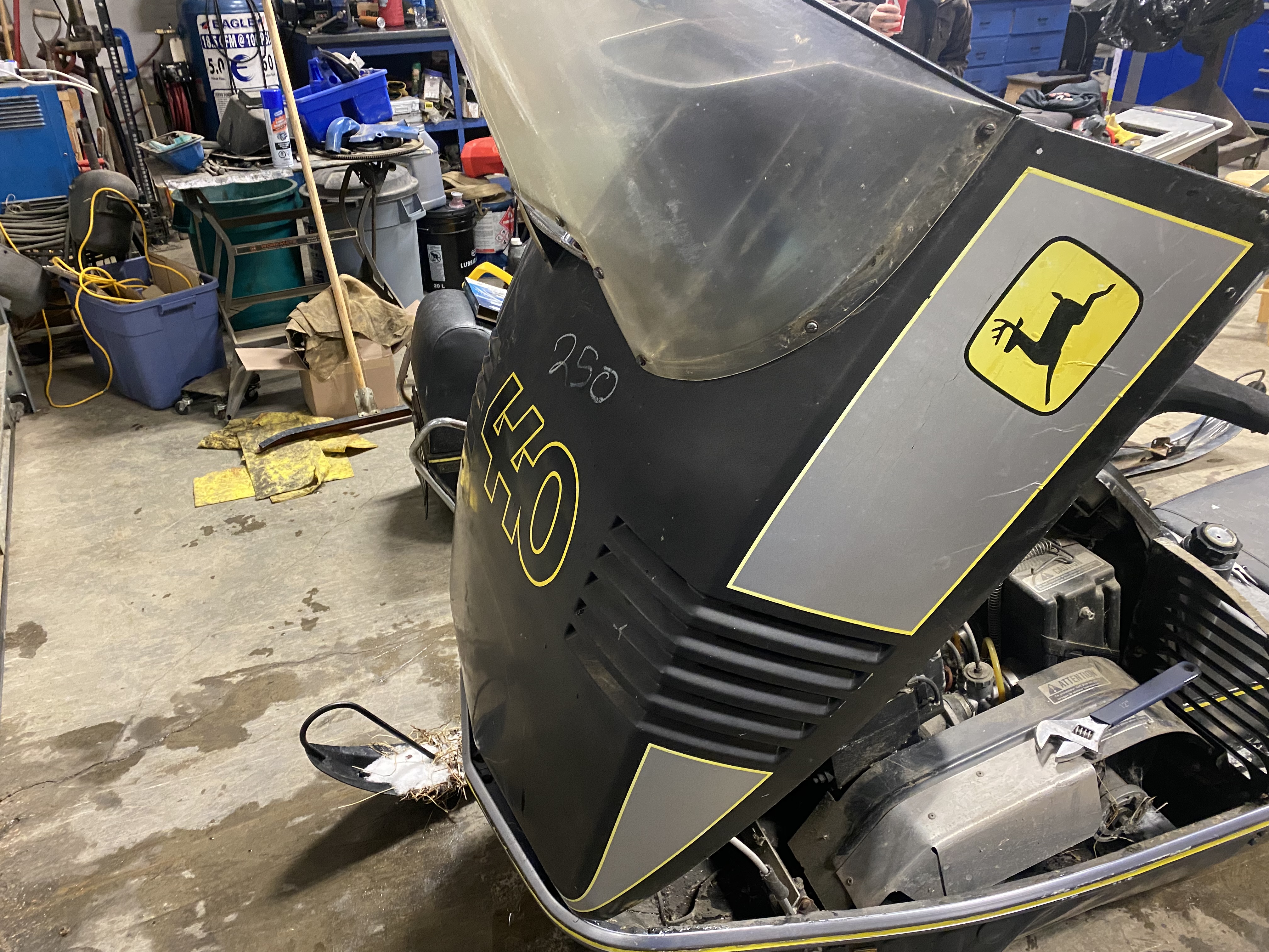

Ok so someone added the cooler on mine then.Thanks airborne. So with full coolers not much chance this runs hot?
Re: 77 liquifire
The photo of the Liquifire didn't give quite enough info, I didn't realize it was green. The 76 and 77s had heat exchangers under the seat, with no bulkhead heat exchanger or radiator.

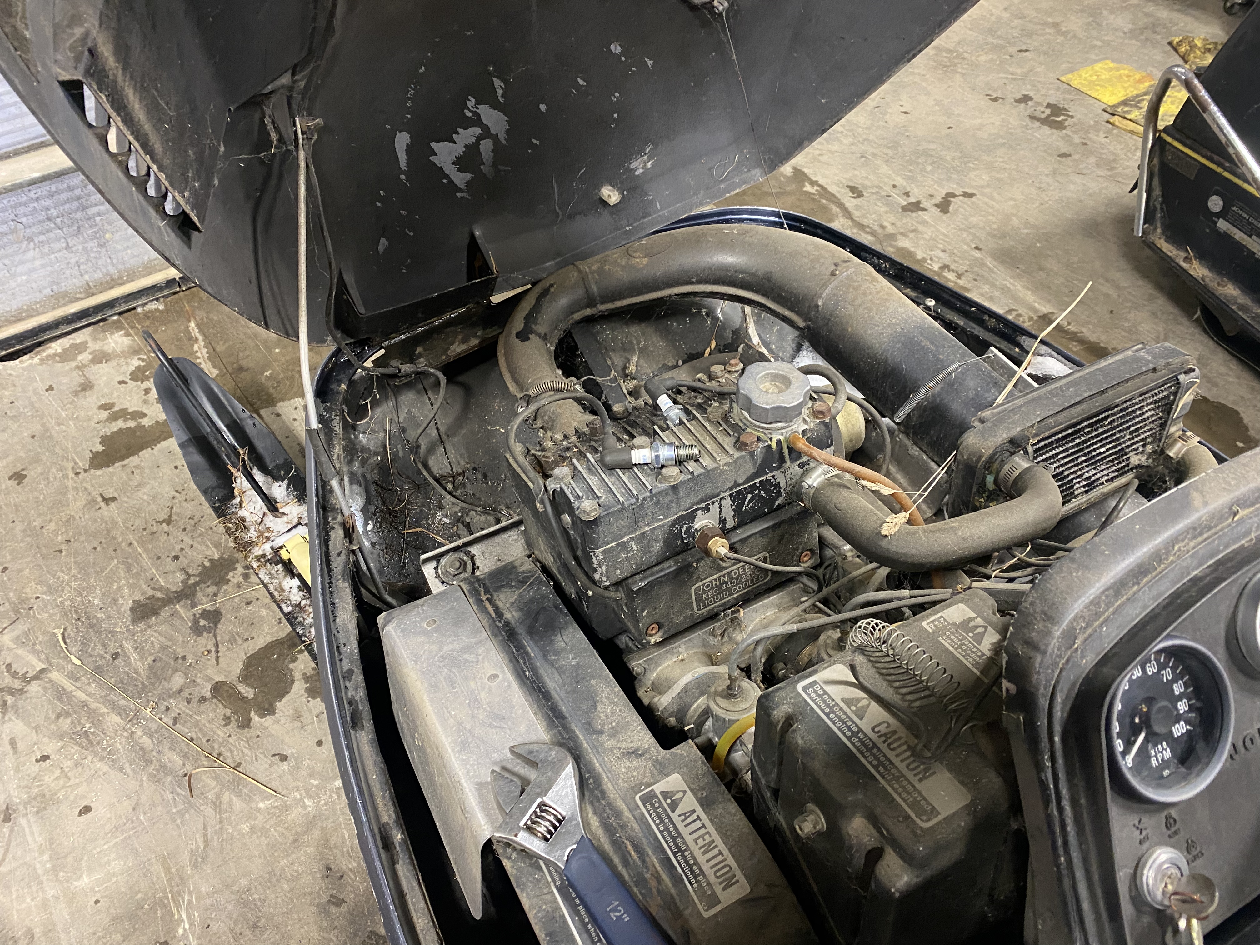

Yes this is very early serial number. Has exchangers under seat and rad. The fellow who had this sled had two. The second one was newer than this but no rad either.
Popcorn popper
Posts: 234
Real Name: Steve
Re: 77 liquifire
Post by Popcorn popper »
This is the one im restoring
Re: 77 liquifire
I assume someone added the radiator, only the 78s came from the factory with one.
