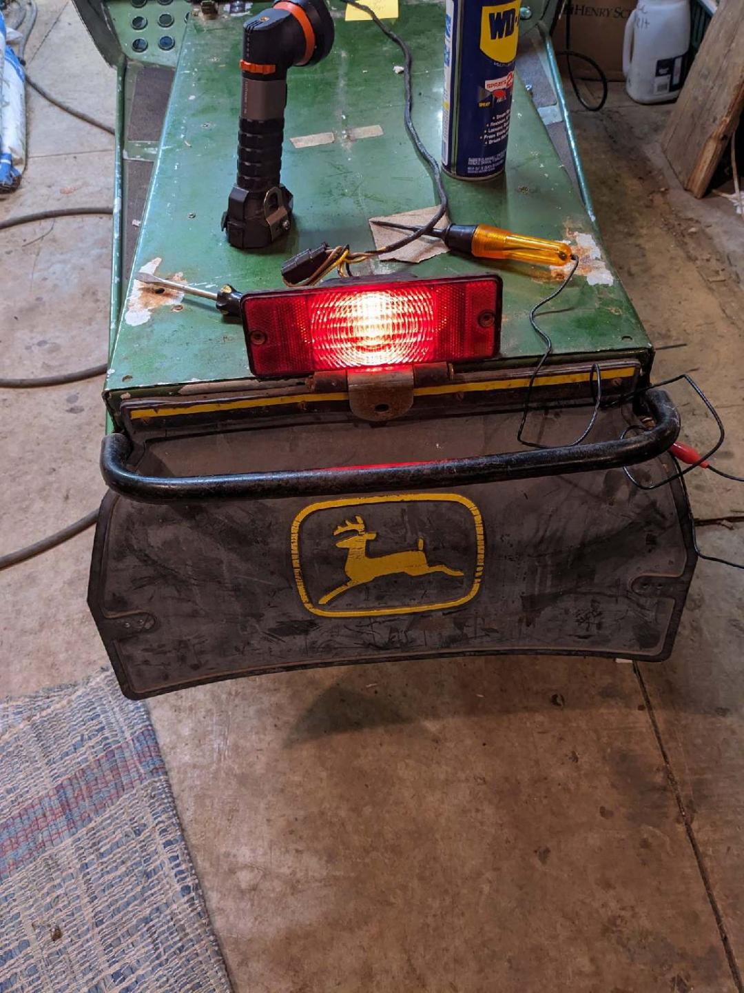

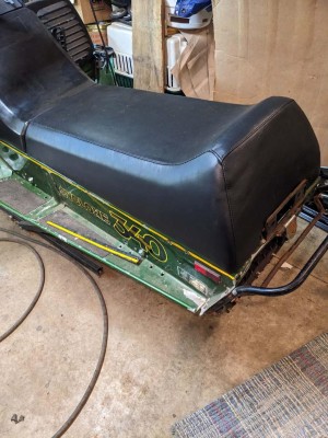

So I did a little diagnosis on the tail light before putting the seat on. The bulb was non-functional and the contacts in the socket were corroded. For the moment at least it seems to be good.
The seat has been installed for good I hope. I removed the snow flap for a deep cleaning.

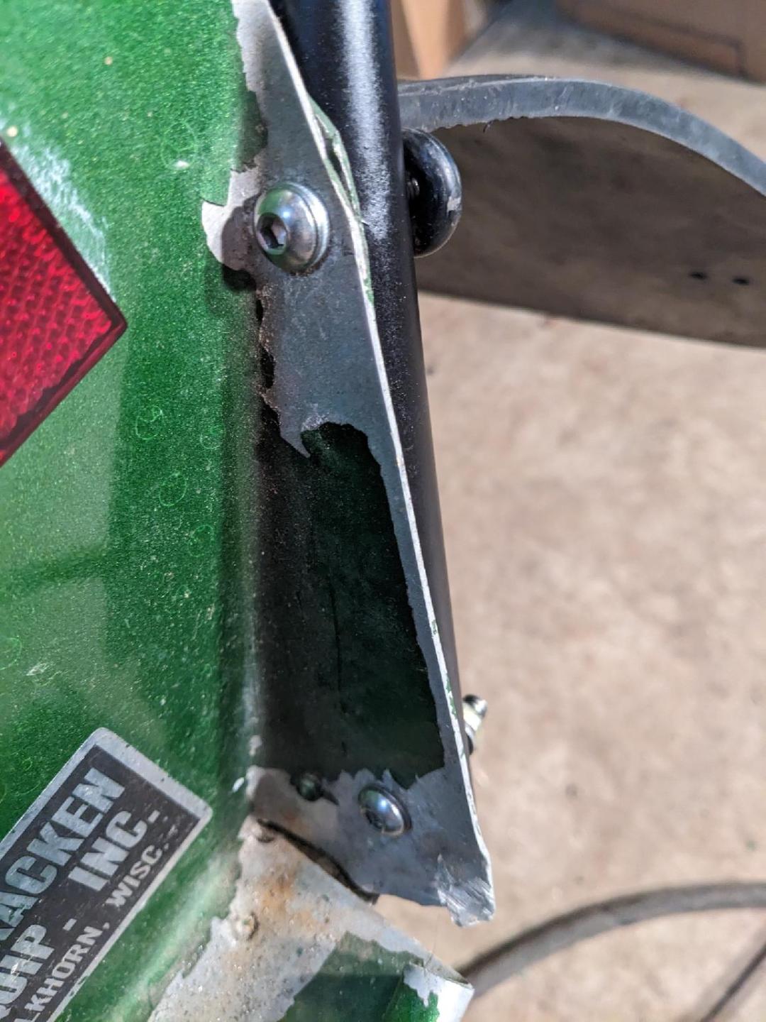

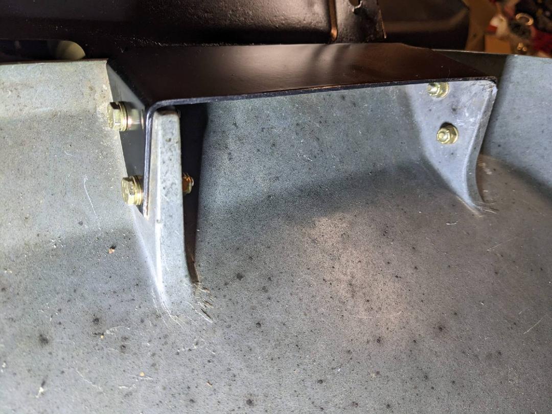

Continuing to tie up loose ends.
The cleaned up flap is re-installed with new hardware. With a coating of snow dust on it, it will look fine.
The flap support is a bit beat up, I'm pondering how I want to proceed with that.
The grab bar is reasonably straight, so I gave it a quick coat of fresh paint.

So I put an NOS flap support on. My brother tells me that this flap is not original, in fact he tells me he got it from me. So I guess I must have bought two flaps from Joe Wanie 15 years ago or so. One went on my 340/S and apparent my brother got the other.
The re-painted grab bar has been installed, I like to use stainless button heads as I think it gives a cleaner look than the hex head bolts.
If this sled runs and works out as well as I am hoping, I may have to revisit the chassis to do a bit of paint touch up.
