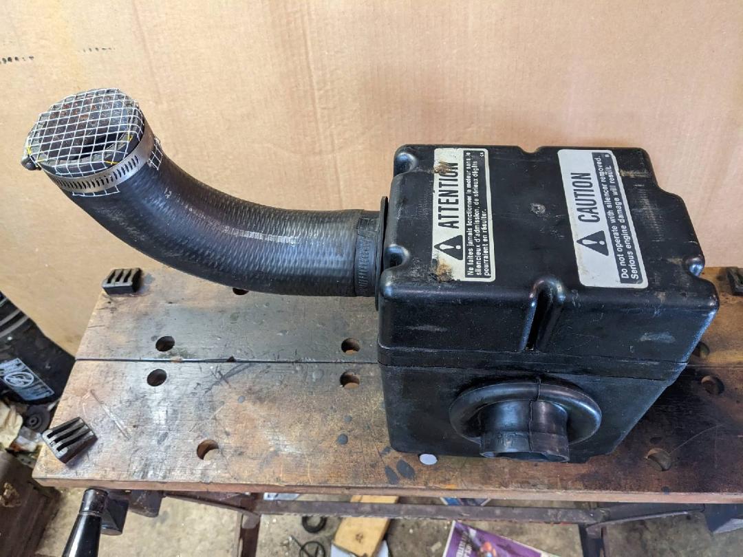

Another little detail...keeping the mice out of the airbox.
I put a short section of tube into the intake hose, formed a piece of 1/4" hardware cloth to cover the end of the hose, Then added a clamp to hold it all in place.
Anti mouse device engaged!

But is it a big problem with mice building nest in the air box in the US?
I can't recall that I have heard anyone having that problem here in Sweden.

Big problem. The exhaust is also a phylum rodentia fan favorite.

Then I understand that you have to seal the in- and out-let of the engines during summer 😄
