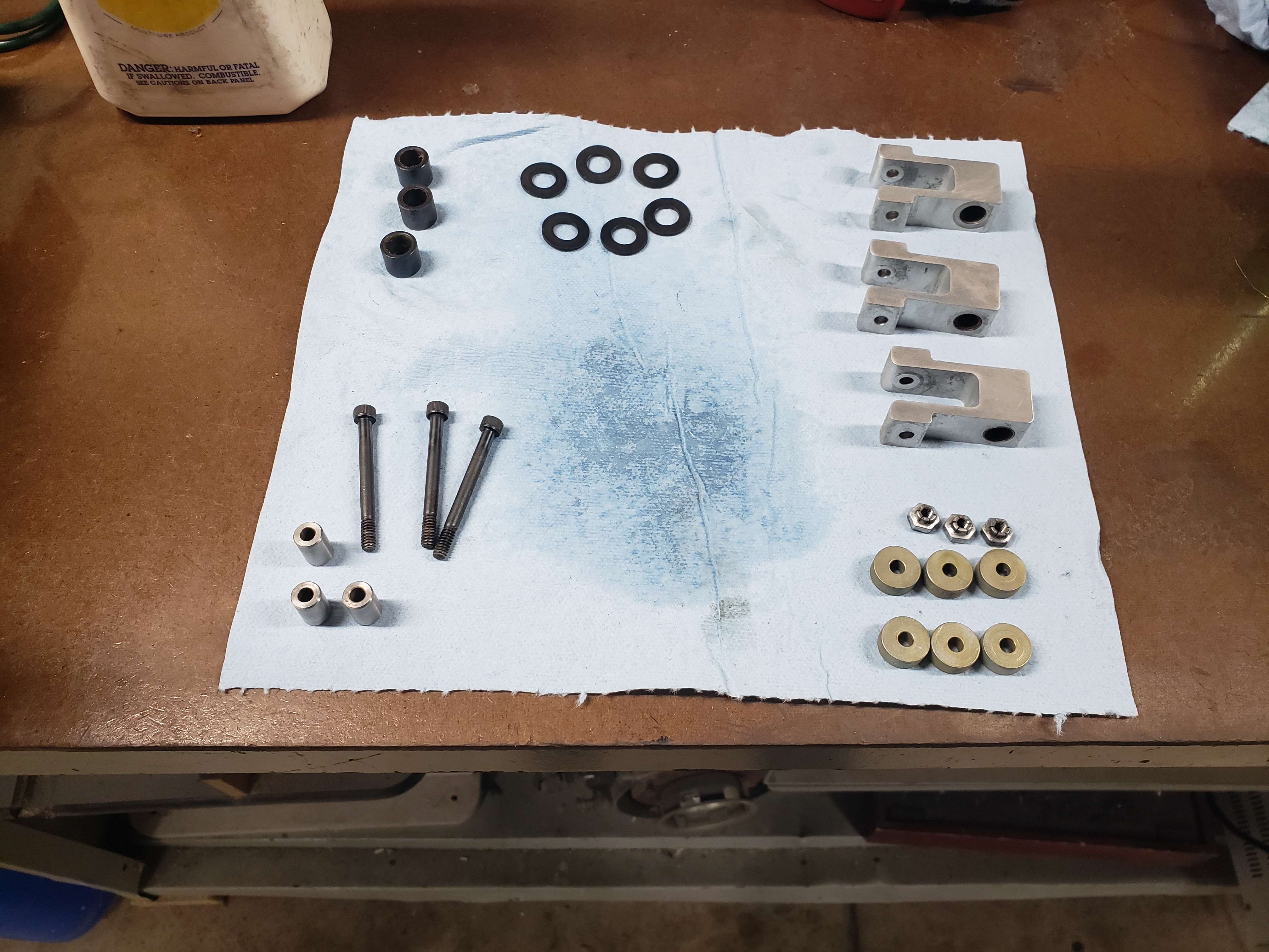

Thought I would toss out a few photos. Progress is slow with this TR800 but it is still moving forward slowly. There was a fair amount of rust / corrosion on this clutch. The thrust washers are toast and the pivot pins should be replaced. The rest of the parts and bushings have cleaned up well.
Spent quite some time vasolating about the thrust washers. Over the years working on the 102Cs I have noticed that back in the day the thrust washers were metal with some sort of slippery plastic (I'm assuming these may have been Duralon thrust washers?). Most of these seem to de-laminate as time passes. If you purchase a Comet repair kit today these thrust washers are plastic. I found reference to them being made of Vespel. I priced a piece of 3/4" x 12" Vespel round but really don't want to go into debt for a few thrust washer.....wow.....they are very proud of the stuff. Next up I made a few washers out of a sheet of Turcite as a test. The stuff I had was intended to be glued to machine ways so I had 2 washers with the slippery sides out. In the end I didn't like the stack thickness (probably could have scraped them to the proper thickness but I wasn't keen on the idea of these from the start). Finally I made them out of Delrin. We will see how this works out.
Last week I spent some time re-plating some of the parts and fasteners but once again my indecisiveness is holding back progress. I've switch back and forth a few times about replacing the dowel pins (because of rust pits). I've finally decided they will be replaced but I'd like to check the hardness of the original pins before ordering new pins (hoping I accomplish this tomorrow).
Anyway, tonight I took a few minutes and assembled the rollers on the arms. At least these are ready to go.
