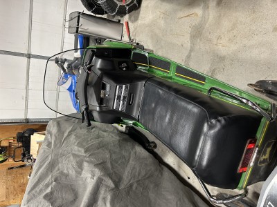

Thanks for the reply! I ended up getting a Kimpex windshield that seems to fit good:
I’ll have to visit a local dealer and grab some screws then. All that’s left is repairing the seat and a few misc stuff - got it running pretty good and have taken the daughter out a few times already!
