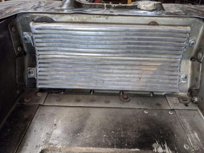

I would leave the heat exchanger as it is. My Ski Doo's have a finned exchanger like this and I have never had any problems with it. Unless you are going to ride in low snow conditions on dirt roads, everything will be just fine.

I took the exchanger fins down to about 1/8" and called it good.
Just have it sitting in the tunnel for the photo, but you get the idea.
I started out with a 40 grit flap wheel, but that was too slow, so I switched to a regular grinding wheel. I have been told the disc would clog, but I really had no problems. I went through 3 grinder discs on this job, and the finished off with a 120 flap disc and then an orbital sander.

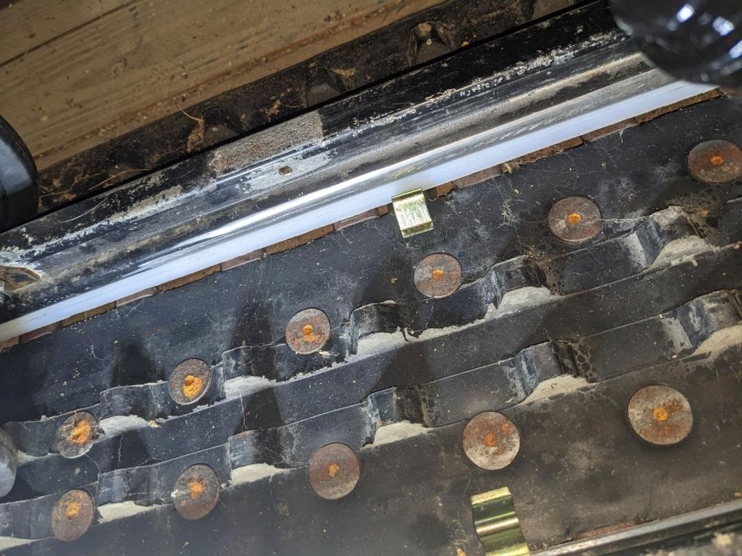

So this is the first track re-clipping I have ever done. It is the first track I have ever owned that has had clips, so this is all new.
I am cutting the clips with a 1/16" disc in the angle grinder. After cutting a few off, I kinda got the hang of it, and I got a lot faster at it.
I make a good pass with the wheel, cool the clip with water from an old Windex bottle, make another pass, cool it again, then look to see where you are. You are trying to avoid cutting into the rubber, and it is easy to do. On most of them, I at least leave a mark. I find it best to not try to cut them completely in half. Cut them thin, then tap a screw driver or small chisel along the groove to split the clip. If it doesn't split, cut a bit more. Once I spit the clip with the screw driver blade, I can pry each half off and pull it out with a pliers.
I have the guide clips off one side now, and I maybe spent an hour.

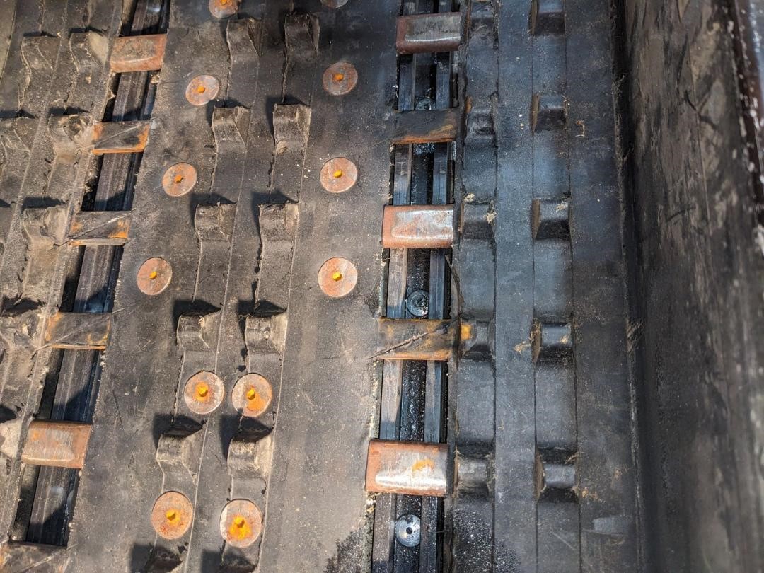

Ok, all of the guide clips are off, once I got the hang of it, it went fairly fast. These clips were not very worn, so cutting them off seemed to be the only option.
To the best of my knowledge, I am the only one who is deranged enough to re-clip the track to the Deere style. While everyone else just puts the rubber track in and runs it, I have narrowed my skid to match the window spacing of the Yokohama track, and am now looking forward to installing the clips Deere used in their place.

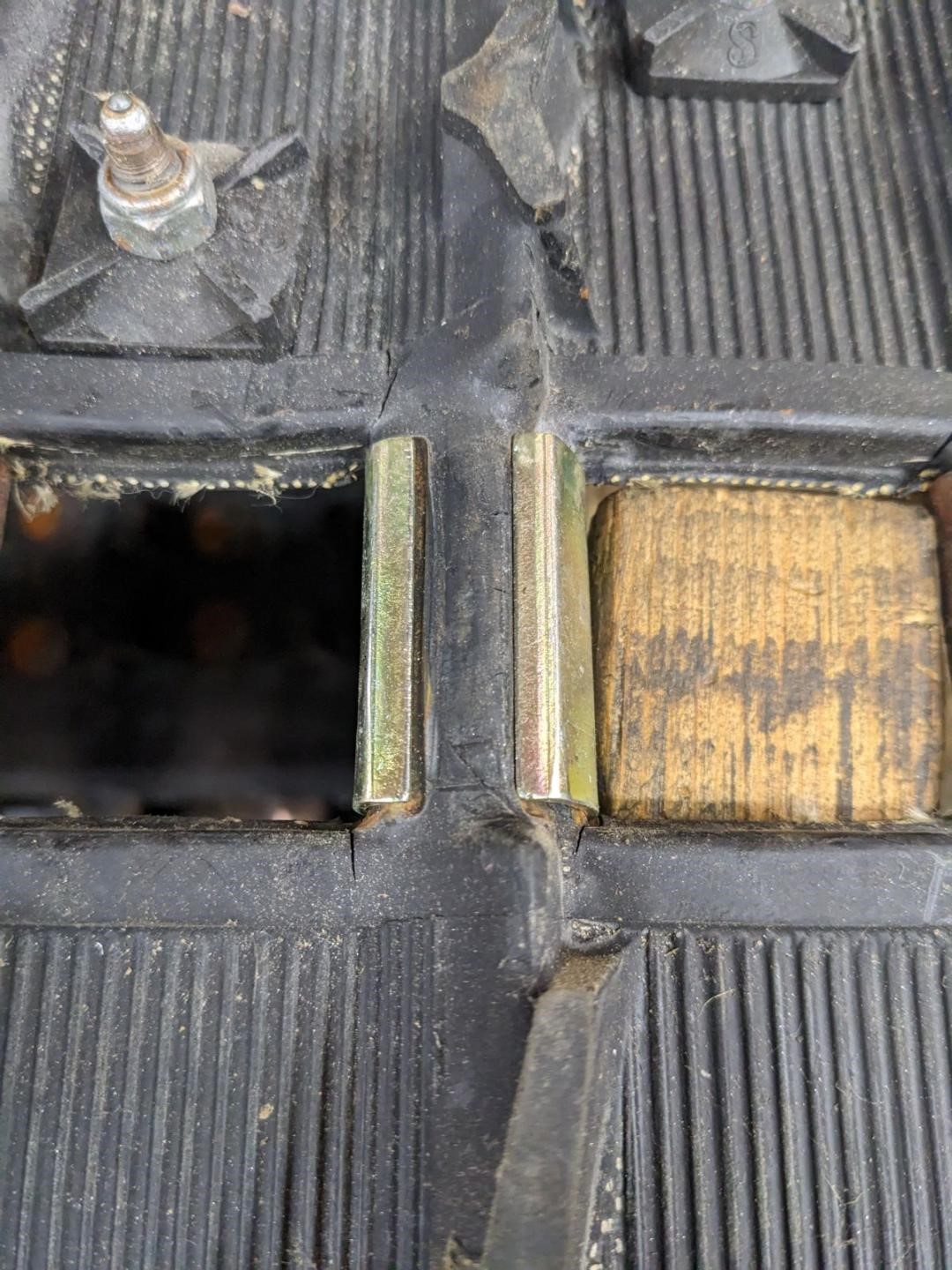

So I started putting the clips on, as usual there is a learning curve. I have 4 on. I quickly identified a couple of issues. The clips kept jumping out of position in the crimping tool. I tried narrowing their spread a little with the hammer on the bench vise so they fit and feed into the tool better and that seems to help. The next thing is that the point in the forming die is cutting into the track. I am going to grind it down a bit and see if I can resolve that.
Re: 78 Liquifire rebuild!

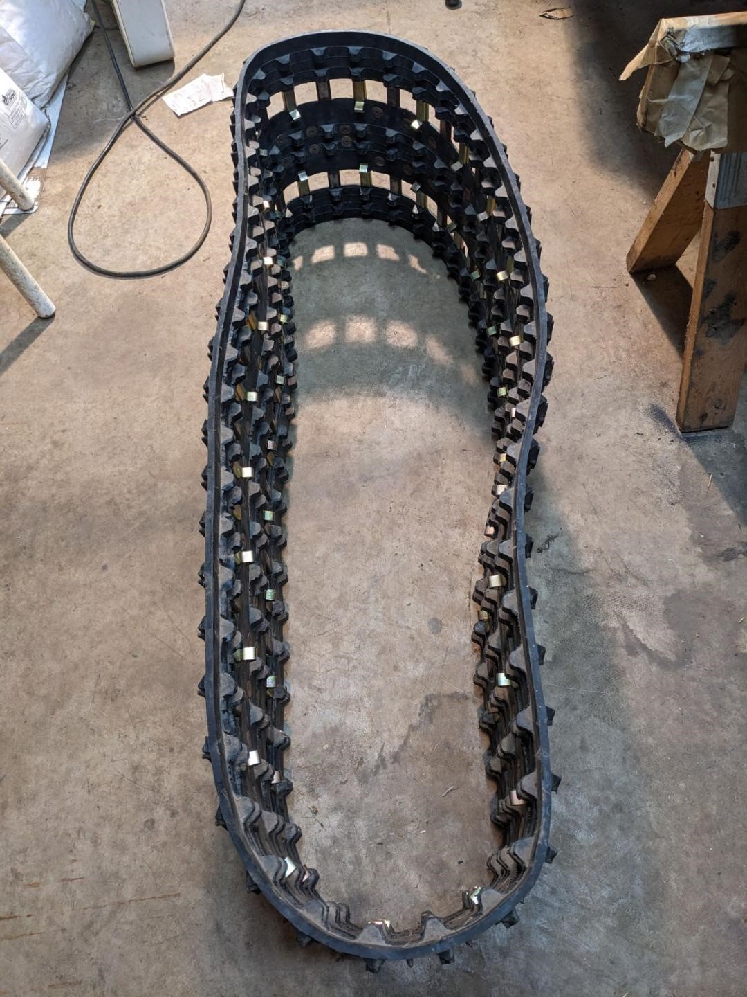

The track is finished! After modifying the forming die in the tool ( I ground most of the point off ) and reducing the spread of the clips before installing them, it all went quite fast. One evenings work to finish up the track.
