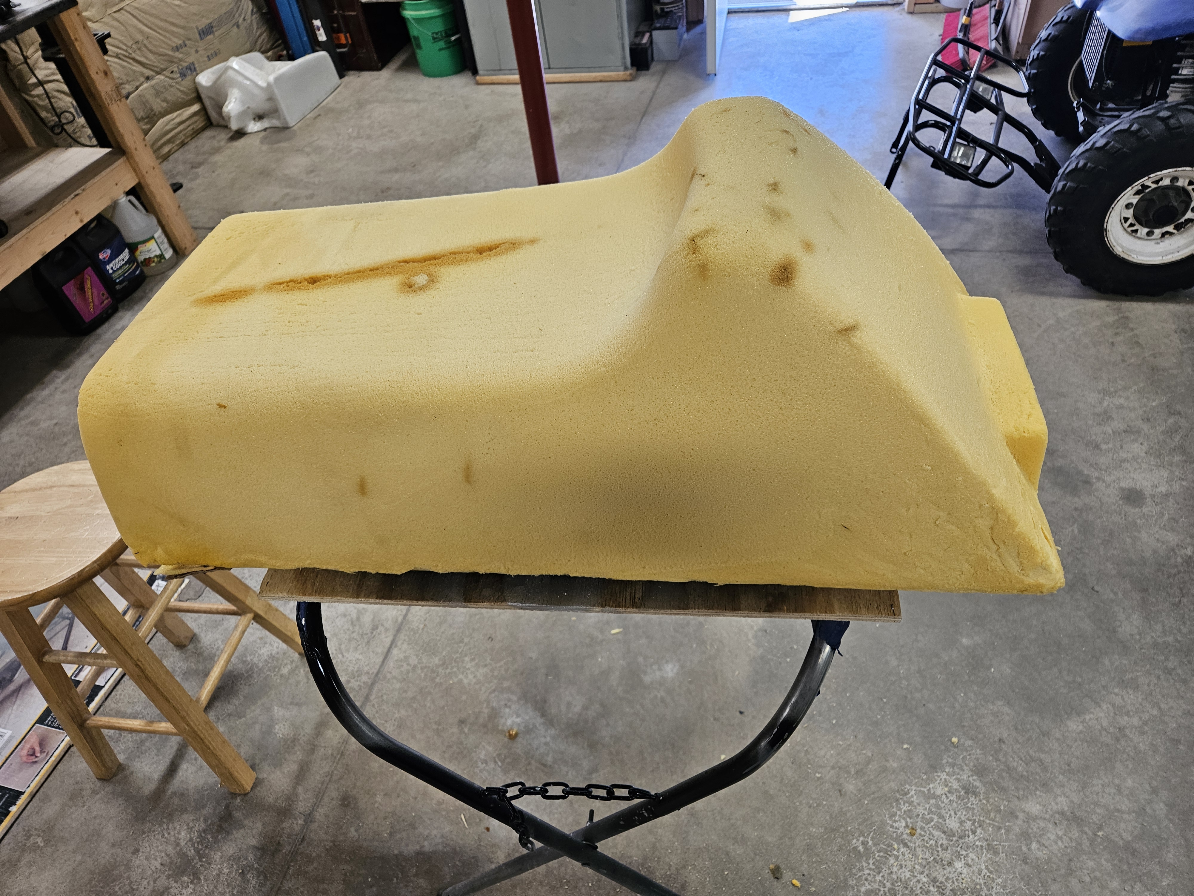

Yesterday John sent me a text saying he shipped my seat cover so I though I should start working on the seat. You may have noticed in the barn find photos that Kevin had this sled setup with a backrest and the trail seat. At first I was excited it was setup this way. Before the sled was disassembled I sat on it and quickly realized this wasn't for me. Kevin was very tall, me not so much. When I was comfortably seated I found myself about a foot away from the backrest. I then had my son jump on the back to see what two riders was like. At the time he was about 15 and weighed in at about 100lbs. With two people I found my knees were in the bars. So for me I don't see the point of the back rest, I would prefer the sport style seat.
I happened to luck out, one of the guys that I worked at the Deere dealership with (who is now retired) decided to get out sleds entirely. He recently had an online auction and all of his sled stash was sold. I managed to pickup this sport style seat.
He told me that this seat had been warrantied by Deere and mentioned that back in the day they replaced a lot of these because of cracking. My assumption was that this was from one of his sleds and instead of it going into the dumpster at the dealership he took it home with him. This is the forth seat I've recovered (third sport style seat), this one seamed much more difficult than I remembered. In the past it seemed like the seats I've done were glued around the hump, taillight, and down by the gas tank. Typically the glue was dried out, boards rotten, foam hard as a rock in places. This one seemed to be glued everywhere and the foam was still very soft. The wood strips were so nice i don't see a need to replace them. Basically just started in one spot and started working it with a sharp putty knife scraping the foam from the vinyl. After 4 hours this is what I have, not to mention a sore back.

Looking great! Definitely lucked out with the seat foam. Any trick to removing the old cover from the foam or did it just come right off carefully peeling away?

bradski12 wrote: Mon Sep 23, 2024 9:10 am Looking great! Definitely lucked out with the seat foam. Any trick to removing the old cover from the foam or did it just come right off carefully peeling away?
I have a sharpened putty knife that I used. I basically started in one area and slowly scraped the vinyl away from the foam.
Buy sharpened putty kinife, I mean I took a flat file to it and knocked the square edge at an angle. I did this about 20 years ago to make it easier to get the putty knife under things to peel them up. It's maybe slightly sharper than a butter knife.
