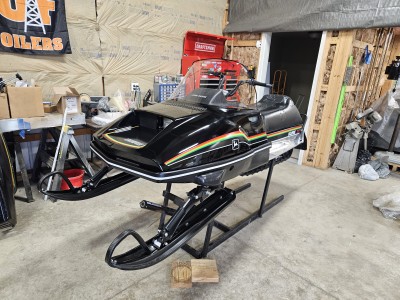

Thanks for the compliments guys. Last night I managed to get the decals installed. It's not shown in the photo but the grill and headlight are also installed. Way back when Rainville did the first buy of the sport windshields I bought a few. The windshield is just sitting on the hood to check the fit. I'm hoping I can get the hood completed and installed tonight.

Thanks Guy. This one has been a real struggle (started in the middle of the great COVID part shortage). Since I'm finally seeing the light at the end of the tunnel I have started to look back on this one and can not believe I have been messing with it for 4 years now. With that said......the hood is installed. The list is starting to get pretty short. Basically waiting for a seat cover from John's, need to fix the rotted battery box, install the e-start system, make a decision on the side vent (replace or use the one I have that has 4 broke mounting stems).
