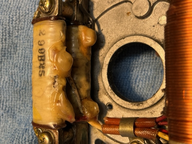

I have a 1981 Trailfire with the fan cooled Kawasaki 440 engine. I removed it, took it apart and installed new seals. It went back together very smoothly. I reinstalled into the sled today and now it doesn't have spark. Any thoughts? Stumped! :(

I found the problem. When I was pulling the flywheel I must have put one of the puller bolts too deep at it damaged the coil.
