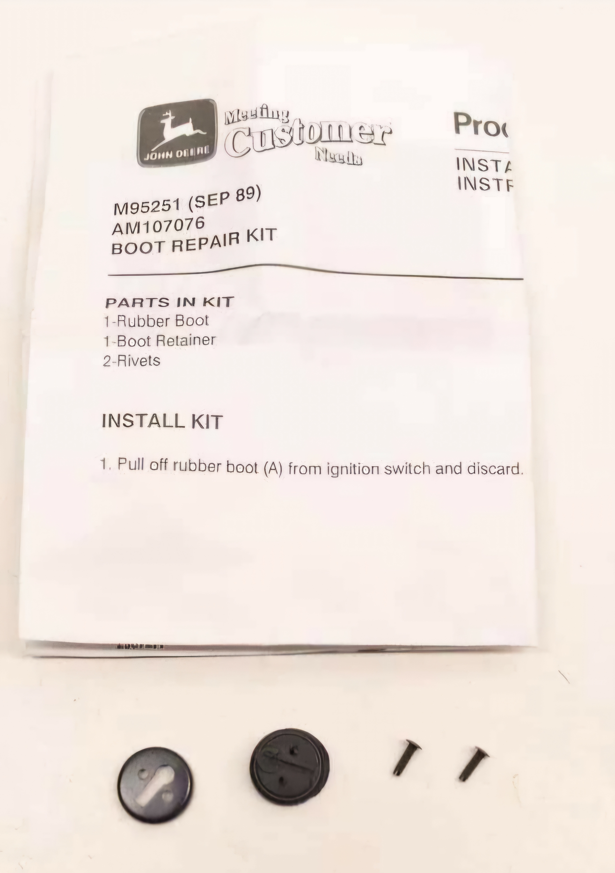

Thanks sorry somehow missed that post below! My switch is fine just the key looks all rusty, would be nice to try out one of these as they're fairly inexpensive.
Re: Kevin's Liquifire
No problem. Also, if your original switch is missing the weather resistant parts (most of the one's I've seen are) Deere sells a kit with those parts (AM107076). I have not installed it myself but I know others that have.

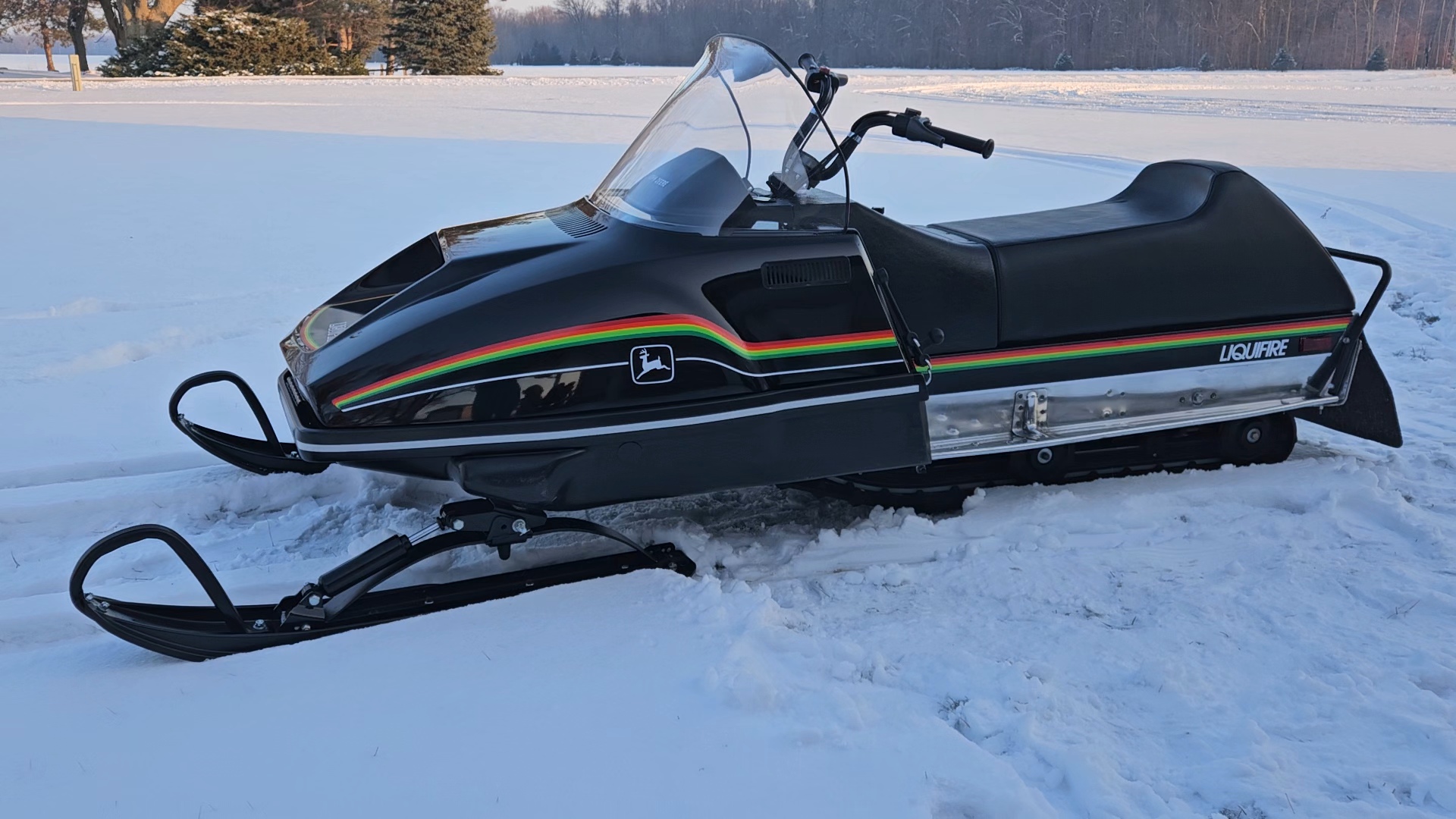

Finally had about 2" or so of snow yesterday evening. Took a little time tonight to get the 82 out for a little yard test and tune session. The new belt seemed to have quite the memory, as a result I had a ton of shims in the secondary. After a few laps the memory was gone and we had to remove lots of shims. It seems like a very different sled than my 80s and we are still getting to know each other. Here's a photo.
