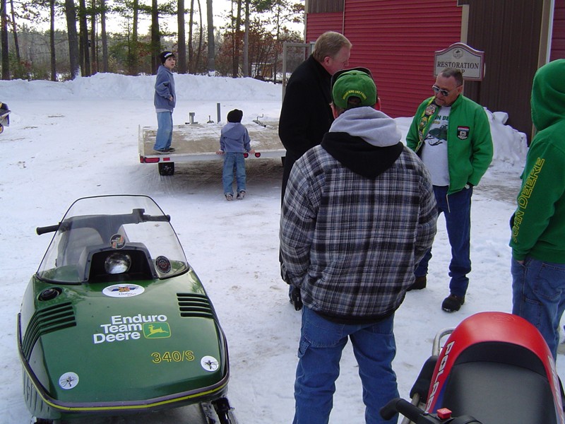

The thing about the 340S is that there aren't many decals to go on it. You have a leaping Deere logo on each side of the hood, and the 340S logo at the front, that is it. This leaves you with this huge area just begging to be used as a billboard!
You could replicate a particular rider or sponsor's look, or come up with a generic race look on your own. Chris Dotzler has the ETD decals like I have on my sled, which was actually used a couple of years later. This would give a generic race look, while recognizing the history.
Or you could have the sled custom lettered in a particular racers colors.
Rainville might have something to add.
- JRC in black on left, Don Amber in green on right.
- HOF weekend 08 340S resize.jpg (154.47 KiB) Viewed 2294 times
