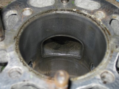

Post by cosmo440 »
Here is the cylinder.
That Girl Racing
Posts: 683
Real Name: Peter
Re: Cylinders
Post by That Girl Racing »
Cylinder looks good. You have the right stuff.
