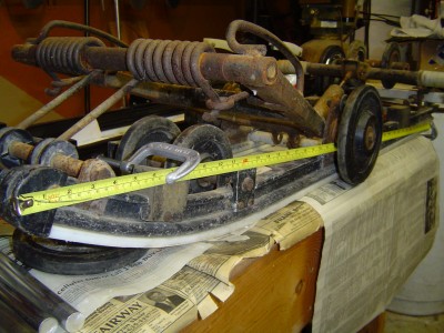

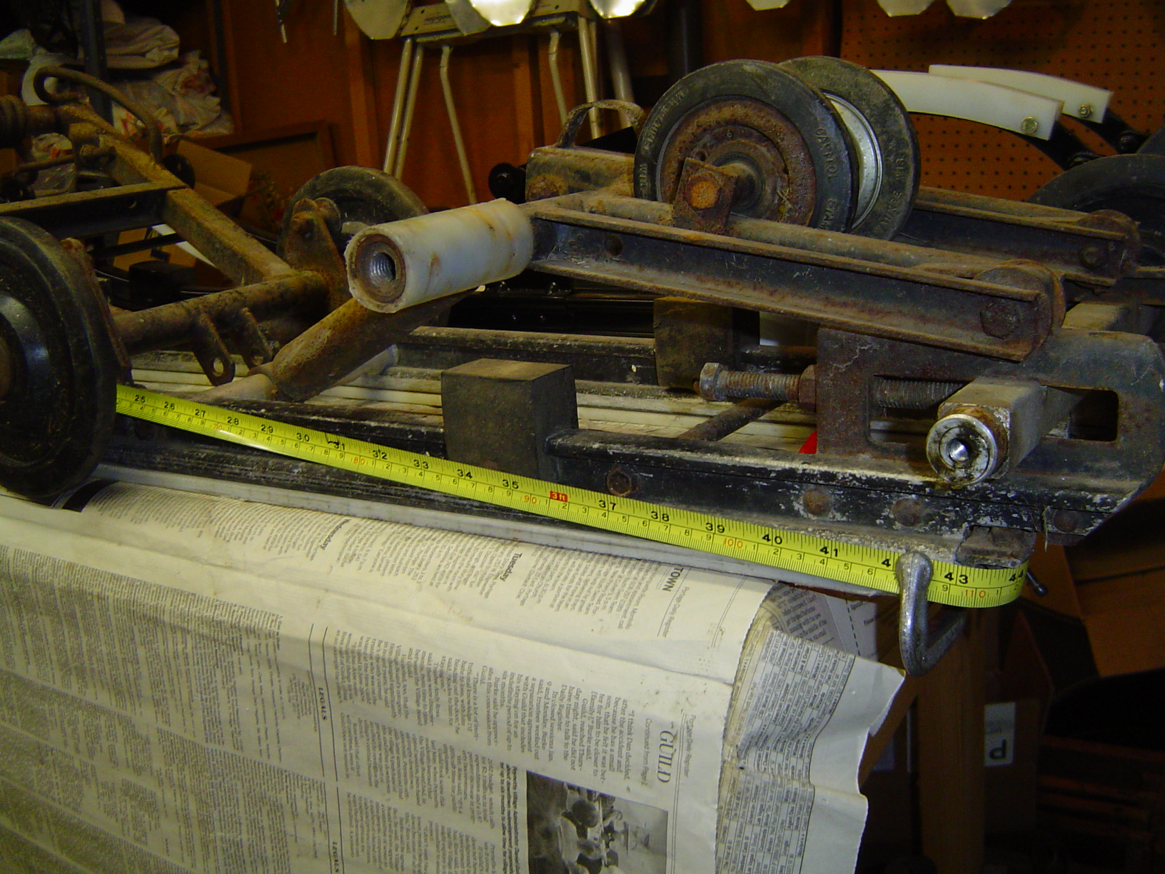

Could someone with a CC suspension please measure the rails for me? Tip to rear end, as pictured.
Re: 78 CC Question
Brian, I find it hard to believe that it's much different than the one you're measuring there. I know it carries a unique part number but a difference in length would surprise me. Mine's tucked away in the trailer but if I get it out I'll measure it for you.

I also had the cc and 80 side by side this summer. Rails are identical except for the length. The 80's are slightly shorter (like 3/4") can't remember exactly right now. The rear axels are different as Kenny pointed out and the axel bracket needs to be lifted and modified slightly to accept the larger idler's from the 78's. Skids are very similar and the clone conversion isn't that difficult. We did 2 of them for our red lake sleds.
