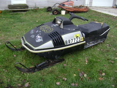

Re: My latest barn find
Sled looks great , I have one of those on my list to get restored its rough right now though. This pic is from when I picked it up a few years ago, in Midland, MI.
