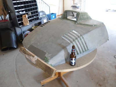

Work on the hood.

Re: 1976 340 Cyclone Restoration
more hood
