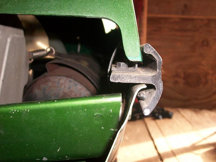

Re: Make A Wish Project 340/S kickoff
Hi again Clack,
Below are pic's showing the rear of the 340/s tunnel, and then the differences between pan and bumper assembly's. In the middle pic, the orginal narrow bumper is bolted on over the glass pan with the ABS hood. This is the pan you have a reproduction of. In the second pic, you can see the "T" shaped Cyclone bumper on the replacement aluminum pan and glass hood.
Note how the aluminum pan is lower compared to the bottom of the hood vs. the glass pan and narrow bumper set up. My suggestion is to trim the top of the glass pan down a bit and fab up a few 90deg. aluminum brackets to attach the pan to the bumper, or cut the tabs off your old pan.
I hope this helps!
-Rainville
I hope this helps!
-Rainville

Sounds good Joe! Thanks for the pictures and the tips.
