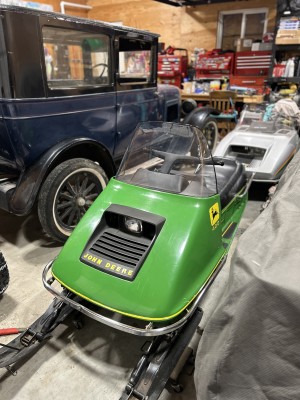

Thanks for the reply! I ended up getting a Kimpex windshield that seems to fit good:
I’ll have to visit a local dealer and grab some screws then. All that’s left is repairing the seat and a few misc stuff - got it running pretty good and have taken the daughter out a few times already!
Thanks
Steve M

The Kimpex windshields are better then the Sno-Stuff ones. I think Kimpex stopped making them so there getting hard to find.
1973 400
1975 800
1975 800 - (Parts)
1975 JDX8
Posts: 1454
Re: 1974 JD 400 Project
I agree on the Kimpex deal. Sure is a clean sled!

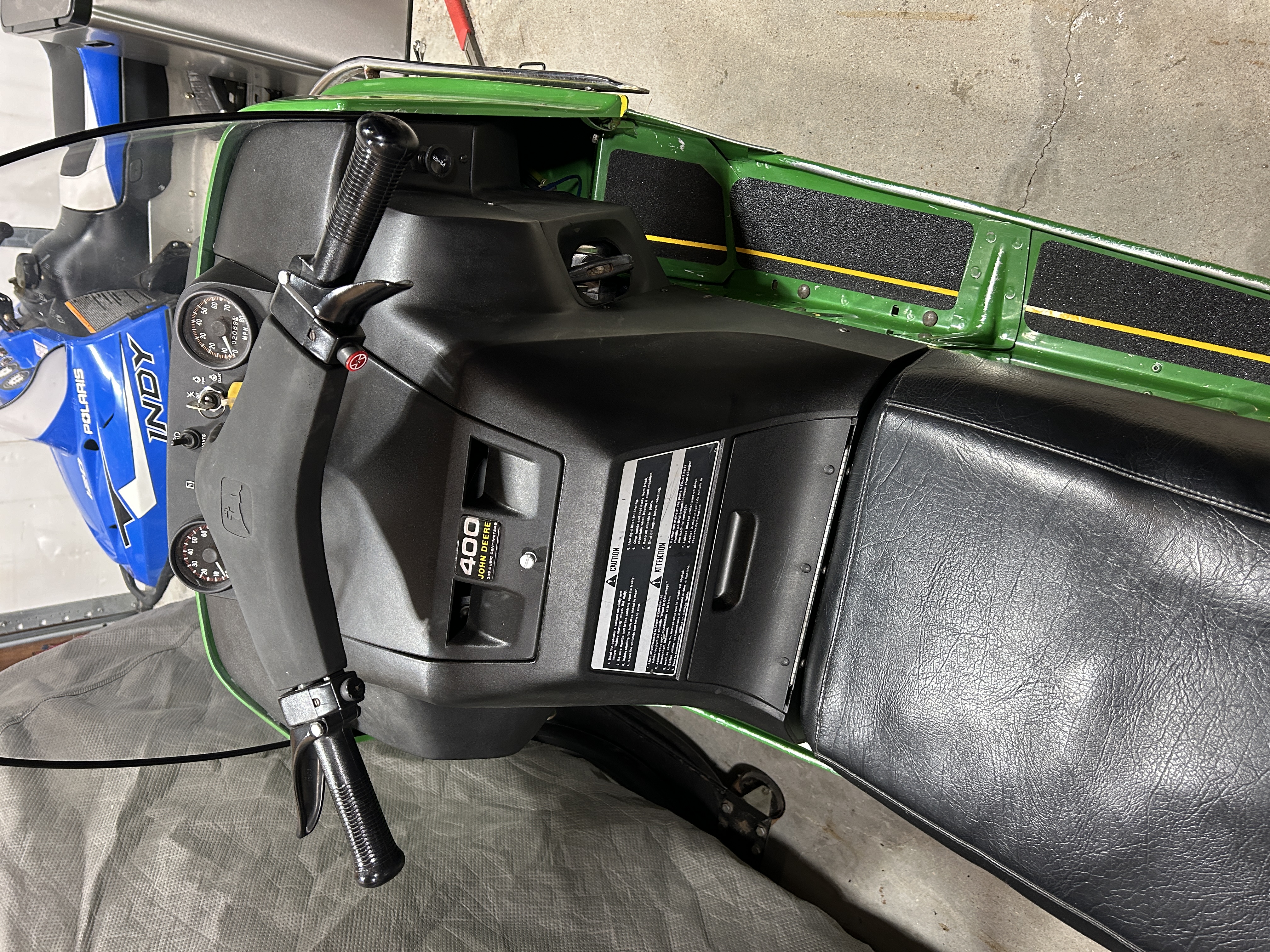

Quick update on this thing - trying to get it ready for the vintage show/parade at CPTC out here in March.
Added new footwell grips/tape - found some stair tread tape that was wide enough and kept the yellow stripe for the JD theme.
Putting some new skegs on as well - a few last misc things and it should be ready to go.
1974 JD400

Post by jep_800 »
Steve,
Just a curious question: where did you source the footboard grip tape? That's pretty cool and very functional. You must have put the yellow stripe in yourself? Yellow piping for the bumper and tunnel perhaps?
