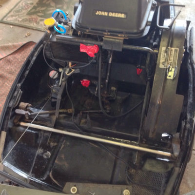

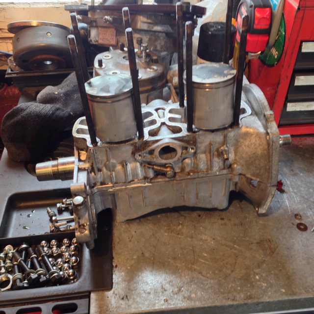

Since it's nice out motor is out and time for a total run down

Nice and clean now

Still some engine and fuel delivery work to do but everything is in place. cosmetic is done.
