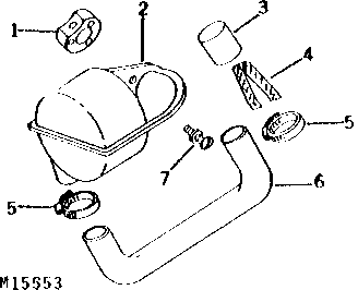

now the bad its missing the drive belt i cant turn the clutch by hand with the track off the ground its missing what ever attachs to the carb the headlight molding thing and the seat ripped all over but has a back rest. Does anyone have pictures on how the air cleaner should look?
Re: new to jd and snowmobiling
There is no air cleaner per se, but it does have an air box that acts as a silencer, and it collects the back spray from the carb and feeds it back into it.

Nice,Thanks for the help with that part could a guy run it with a filter instead or jerry rig someting up
There really was no air filter. There is a screen over the end of the intake hose to keep the mice out ( number 4 ).
Number 3 is a foam cover, but they turned to dust or were tossed because they would ice up.
