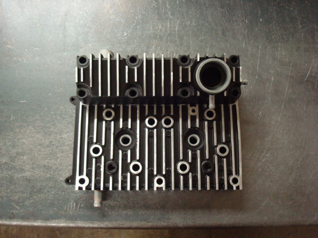

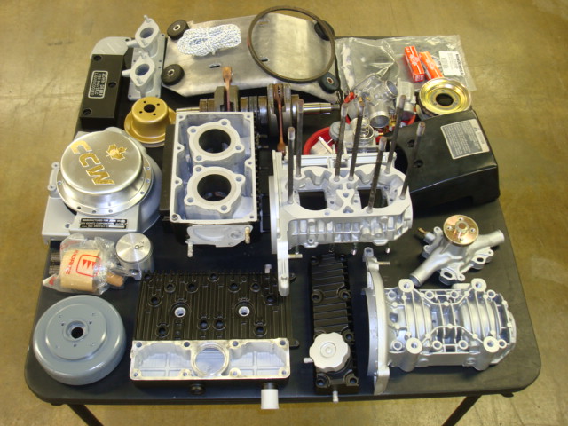

I've been working like a mad-man lately to get everyone's engines restored/completed for their sleds, so I thought I'd snap a few pics of DA's fully restored, 1978 JD 340 LF engine I've been toiling over, chocked-full of NOS parts. He should be able to hear his new baby cry for the first time by Christmas Eve! :pray: :)

DA had a freaking cow when he saw the thread topic!!!!!!!!!!! Actually DA and BA are going to be great-grandpa and grandpa respectively in May.
The water pump cover in the picture is not the actual cover. I'm saving that picture for now.
Hint: The "Busco Bullet" is back.

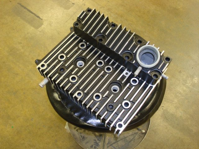

A little machine work done to improve the asthetics a bit for a more "high tech" look, since Mr. Bullet likes that kind of stuff. :sled:
