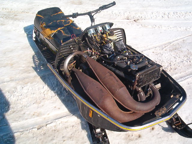

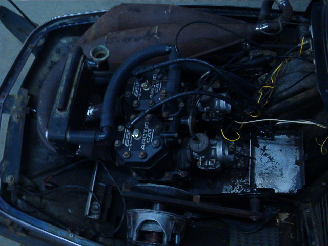

Well I have been working on a dator clone Much Like KWC. Been planning for quite awhile (like a yr or 2) Now I got my dator restored I hate to wreck that so the clone comes in to play. Built on a 76 LF frame with a dator hood. I decided on an 88 A/C Wildcat 650 powerplant. Used the W/C pipes slightly modded to fit the chassis. The front radiator is out of a 80 LF for the true dator radiator. Most parts will still be JD though. so far I have been mostly working under the hood.

Doesn't look like there's alot of room under the hood for those pipes. I might suggest some insulation on the mag side pipe to save the hood. Looks good though.

Pipes are a bit tight. They do have some clearance. But the pipes will be coated and the hood will have reflective heat sheilding under the hood.

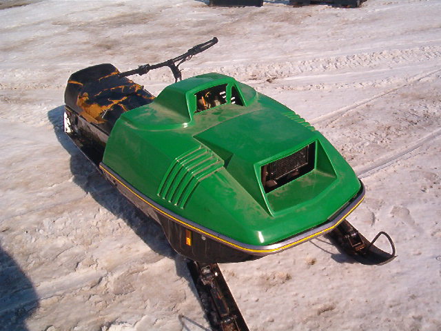

Well got it outside and driving after having some carb issues. Overall it was a good day. still has tuning issues and my tach doesn't quite work right yet and I need the correct belt. But it seems to run pretty well its a rocket once it get wound up.
And the hood still fits!

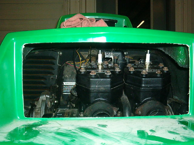

Well, Progess has been slow lately But I am getting there. I got most of the eng problems solved(at least till next yr) I managed to get 13 miles on the speedo. I upgraded the susp to an 80 LF for more travel and less weight it went in easily the hood is finally mounted and I think paint will be applied to it this week.
now that it works time to tear it all apart and paint it! I hope this is the easy part.

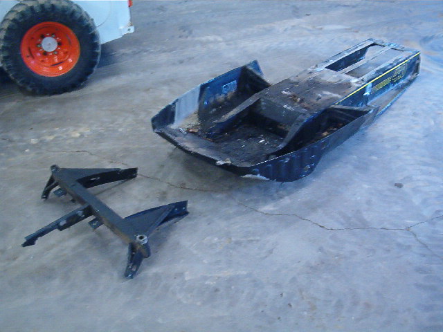

I guess theres no turning back now.....
tore down ready for paint (after a good cleaning) The goal... have it ready for Milbank. Can I make it Todd?
